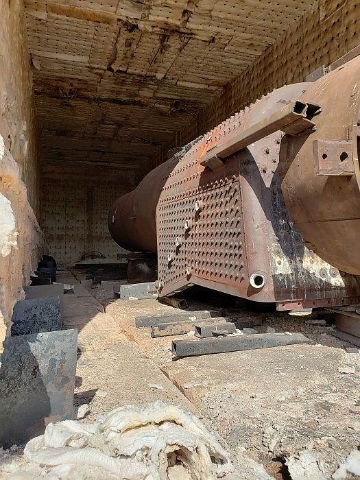

Kelly was correct, In one of their newsletters they talked about Continental Fabricators having an oven big enough to stress relieve the whole boiler when completed. That is one of the reasons they went with Continental.

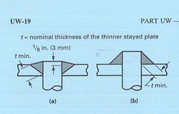

They also said they were going with all fillet welded staybolts. Can someone explain the difference between fillet welded and regular staybolts? Kelly?

Here is a shot of the 1385's boiler in Continental's oven. I realize at this angle the perspective is a bit hard to catch but there was plenty of room.
File comment: 1385 Boiler in Continental's oven
As far as stays, besides the fillet attachment there is full penetration weld and threaded/upset. Which flavor is what you were thinking of as regular stays?
Fillet-welded staybolts are staybolts attached to the boiler sheets with a fillet weld. In many parts of the world, these have been the "regular" type of staybolt for many decades. There has also been quite a bit of study on the stresses of the rear boiler which led to conodial profiles along the shaft with enlarged heads to distribute bending stresses more evenly and provide an enlarged attachment area by the increase in circumference.
There are a number of locomotives already operating in the U.S. with staybolts attached by fillet welds. Additionally, ASME locomotive boiler code allows their use and relates this design methodology.
Rather than trying to filter through all the arguing and personal attacks and other BS on the previous thread, for the beginner the simple version is this: welded staybolts use a straight bolt that's welded to the sheets - either with a fillet or a full penetration weld, and traditional staybolts are threaded through both sheets and traditionally the ends are peened over to seal them against the sheet. A later development was seal welding the threaded bolts rather than peening. Boilermakers today use any/all of the methods, although full penetration welds have unsatisfactory flexing problems in locomotive boilers and fillet welded is acceptable for long-life service when a specially designed bolt is used. Welded bolts are somewhat quicker to install but require high quality welding work, traditional threaded bolts take a little longer but are a little less finicky.
Full penetration on the left and fillet on the right (weld is the shadowed areas) in this illustration:
Of course if you're a masochist or have the desire and time to spare, by all means dive into the other thread...
