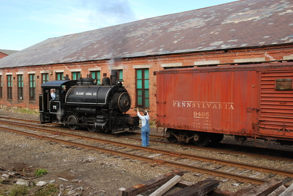

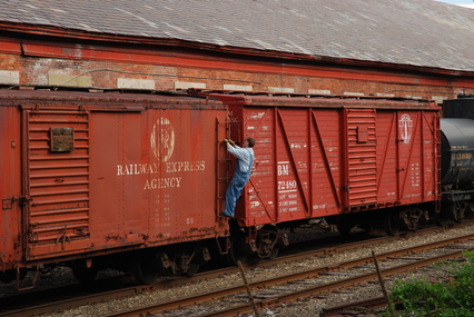

That's a great looking X29. As usual, the Everett people have done a great job.
Here's a couple of images from 2010, showing RMNE's X-29 (express car version), and one of our B&M XM-1 single sheathed cars, posing with FC 75 for some freight photos at Thomaston, Conn. The old Plume & Atwood brass mill building in the background is now gone.
Our car is now rusting though the lower side sheet patches applied during PRR days (1950s?) to these cars. Time for some in-kind repair work.
We used original PRR lettering drawings for the letter and number alphabet, and a general arrangement drawing for the lettering layout for the express car version (which ours actually is).
MP 6 on The Naugy
