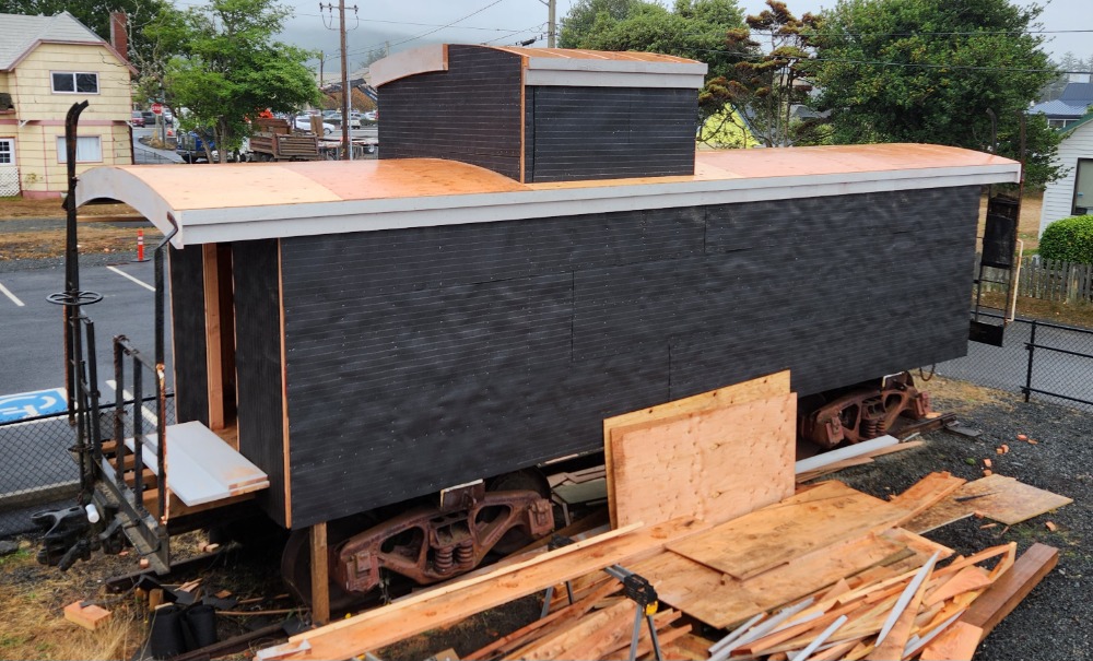

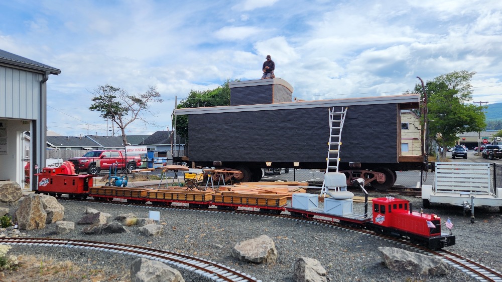

They start laying the roof tomorrow.

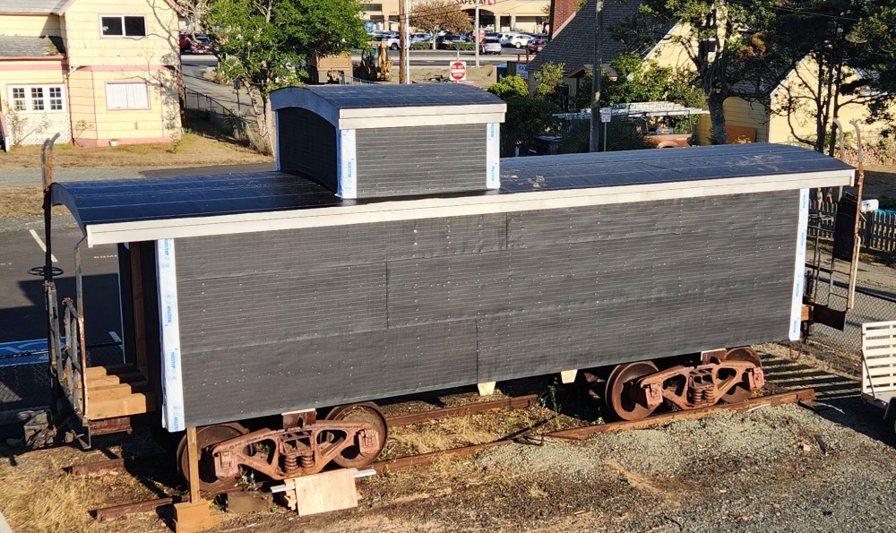

Today's progress.

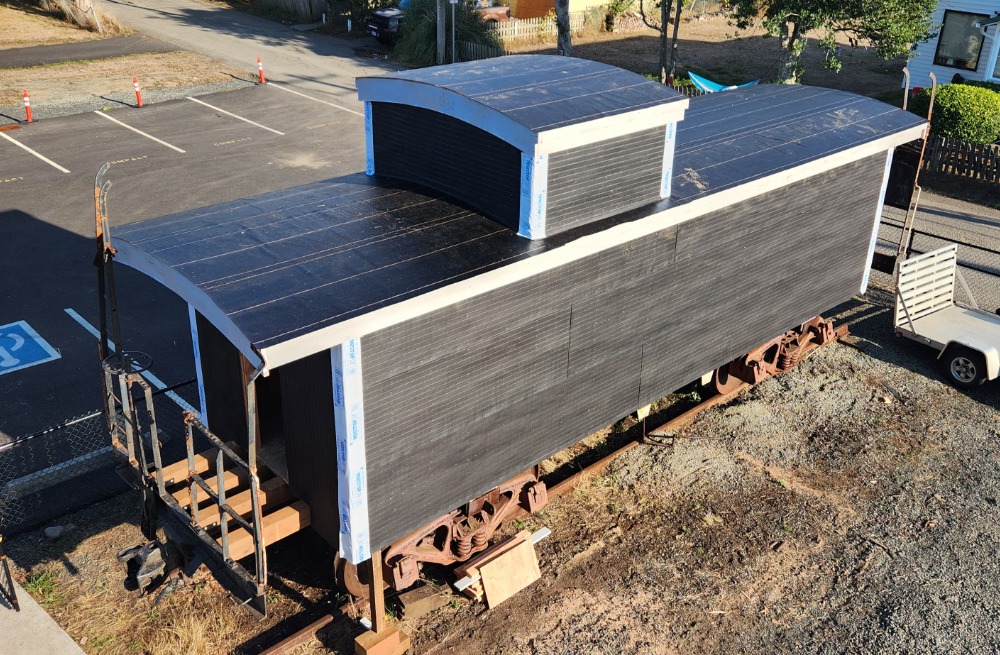

Got the main part of the roof covered. Cupola tomorrow.

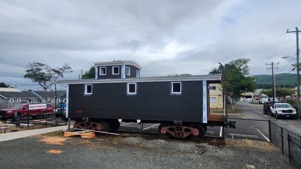

Posing with the Seaside Shortline Railway!

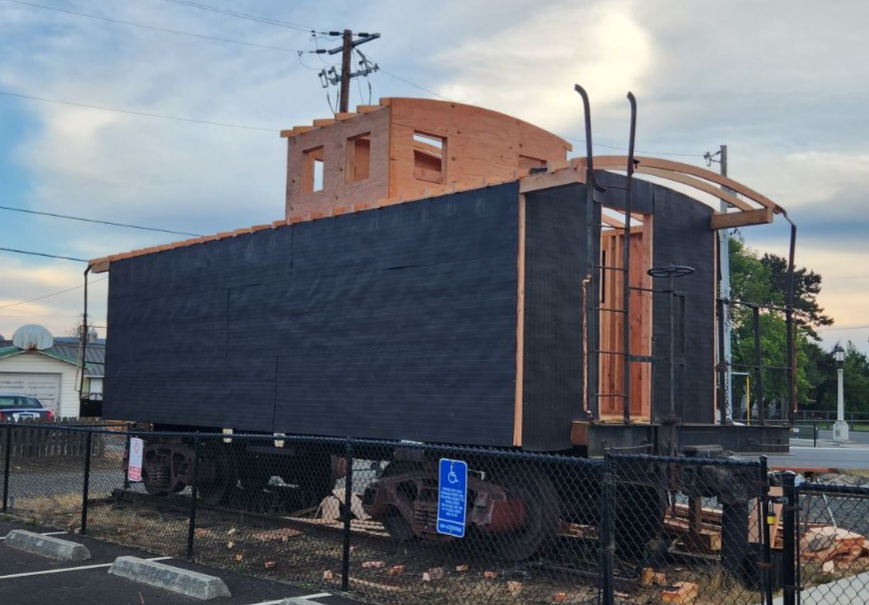

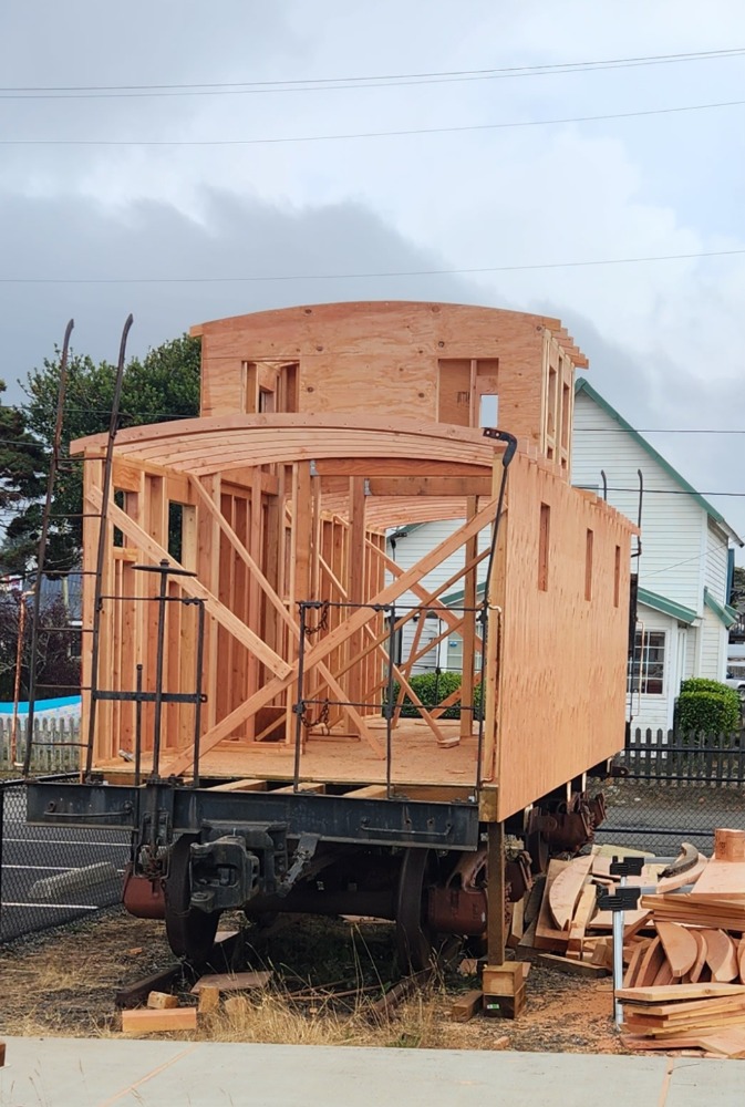

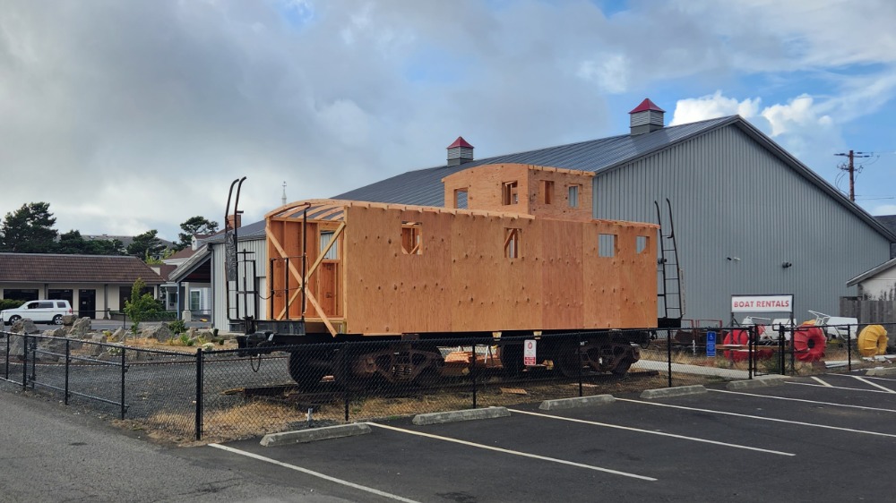

All ready for roofing and siding!

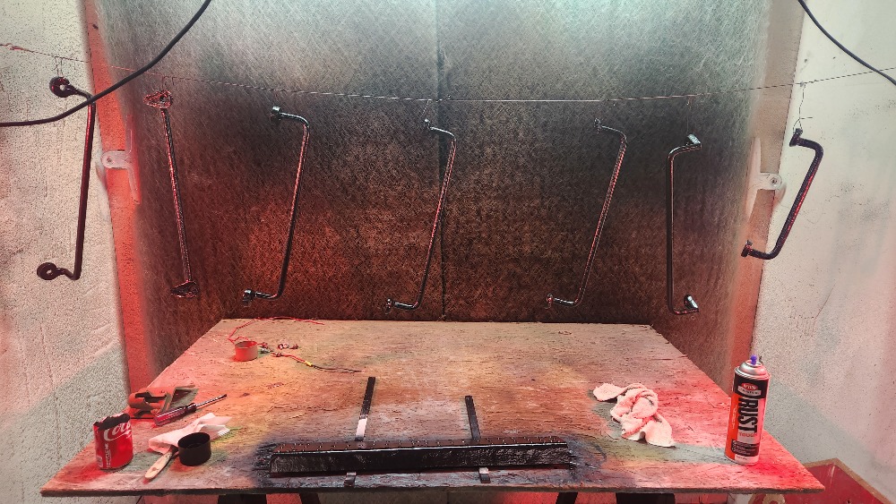

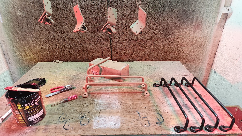

I'm sandblasting all the railings, handholds and brackets. I use a zinc chromate primer on the bare metal followed by 3 coats of Zero Rust. Zero Rust is a high solids phyenolic-modified alkyd coating. It will fade over time, so I top coat it with 2 coats of Industrial Krylon.

jayrod wrote:
Black hardware, freight car brown body and white lettering. I think you’ll be looking quite 1938-ish.
I tried colorizing the 1938 photo with some free online programs and the caboose always comes out reddish brown. It's going to have to be more red than that! I'll be looking at some color chips in the cherry red area, as described in Paul Hobbs book.

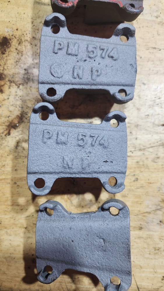

I've got three varients of marker lamp brackets. Two have "PM 574 NP" with a NP symbol cast into the bracket. One has "PM 574 NP" without the symbol. The 4th is lightly stamped "662".

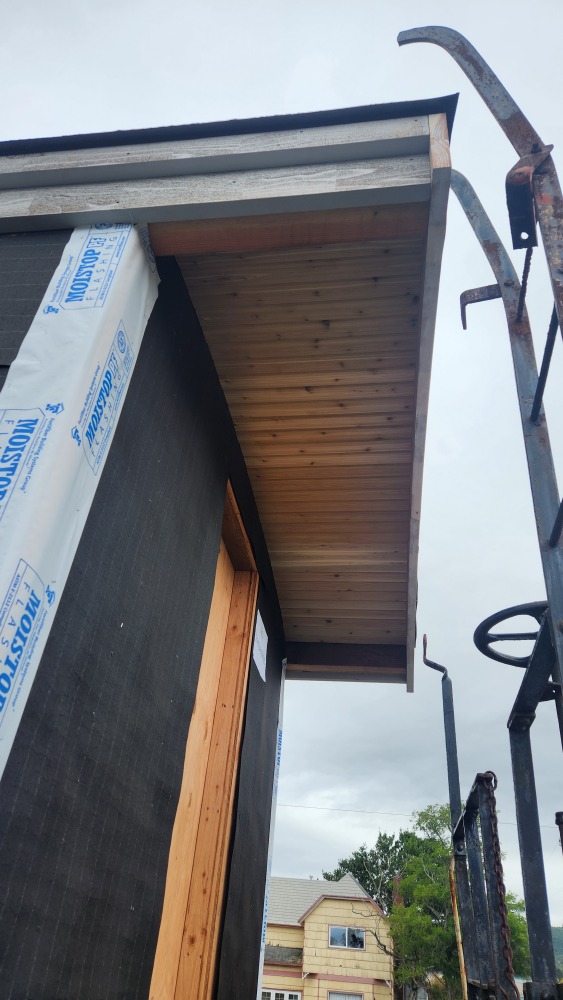

Western red cedar on the platform ceiling.
