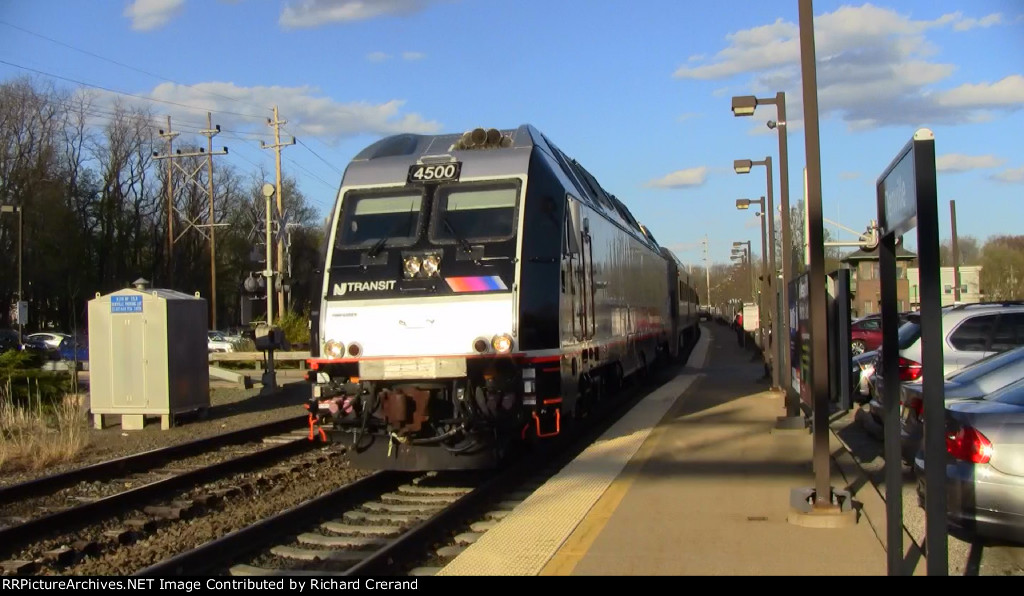

Perhaps one should consult with New Jersey Transit to find out their secret then, NJT restored to operation nine dual-powered ALP-45DPs and 84 multi-level rail cars swamped in salt water at Kearny NJ by the storm surge during Hurricane Sandy in 2012. They obviously decided it wasn't a lost cause.
I really don't understand the animosity toward the restoration of AC&Y 505, if someone wants to restore it that is their business.
Photo by Richard Crerand, 2014, caption: "ALP-45DP 4500, the class leader, is on the point of Train 1055. This was actually the first revenue run of this unit since being damaged by Hurricane Sandy back in 2012." http://www.rrpicturearchives.net/showPi ... id=3833590
Edit: if you look at this cost sheet for the damage "NEW JERSEY TRANSIT SUM OF SUPER STORM SANDY PAYMENTS AS OF SEPT 30, 2017" on page 191 you will see that they paid Siemens between $11k and $30k for traction motor repairs. http://njtransitresilienceprogram.com/w ... OR_RPT.pdf
