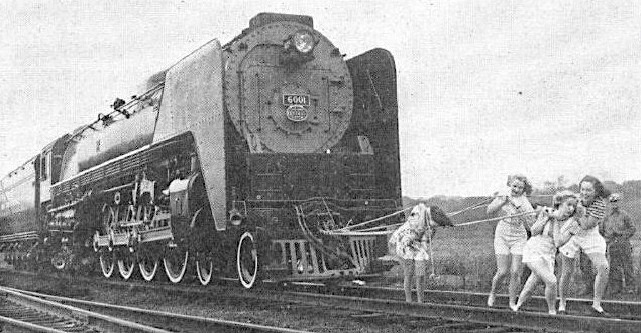

Legend has it.... it was the Timken Company itself, that started using the term "friction bearings". A marketing ploy to sell their new "better" roller bearings into the very conservative railroad world. Plain bearings do have higher starting friction, but only for seconds. Once moving, the "bearing drag" is the same as RB's.

Timken used the higher starting resistance of a plain bearing, to their advantage.
The marketing dept. used publicity stunts such as this... young lovely's moving a RB equipped locomotive.
