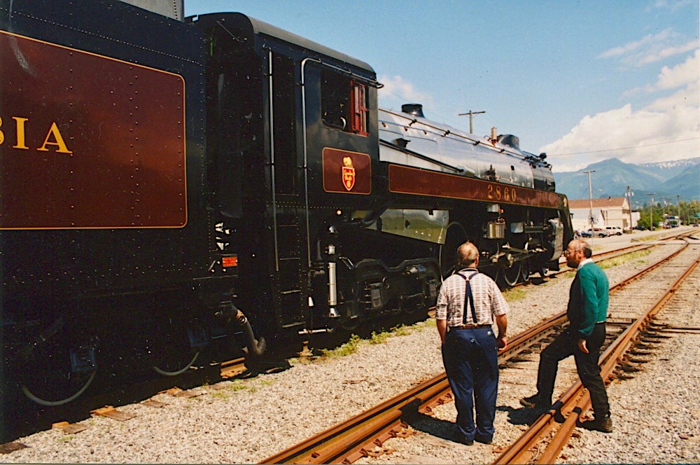

Back when BCRail were operating the Royal Hudson...
the preferred fuel of choice was Bunker-C.
Vancouver was a major seaport, and BCR serviced the dock's..
Readily available...and cheap.
