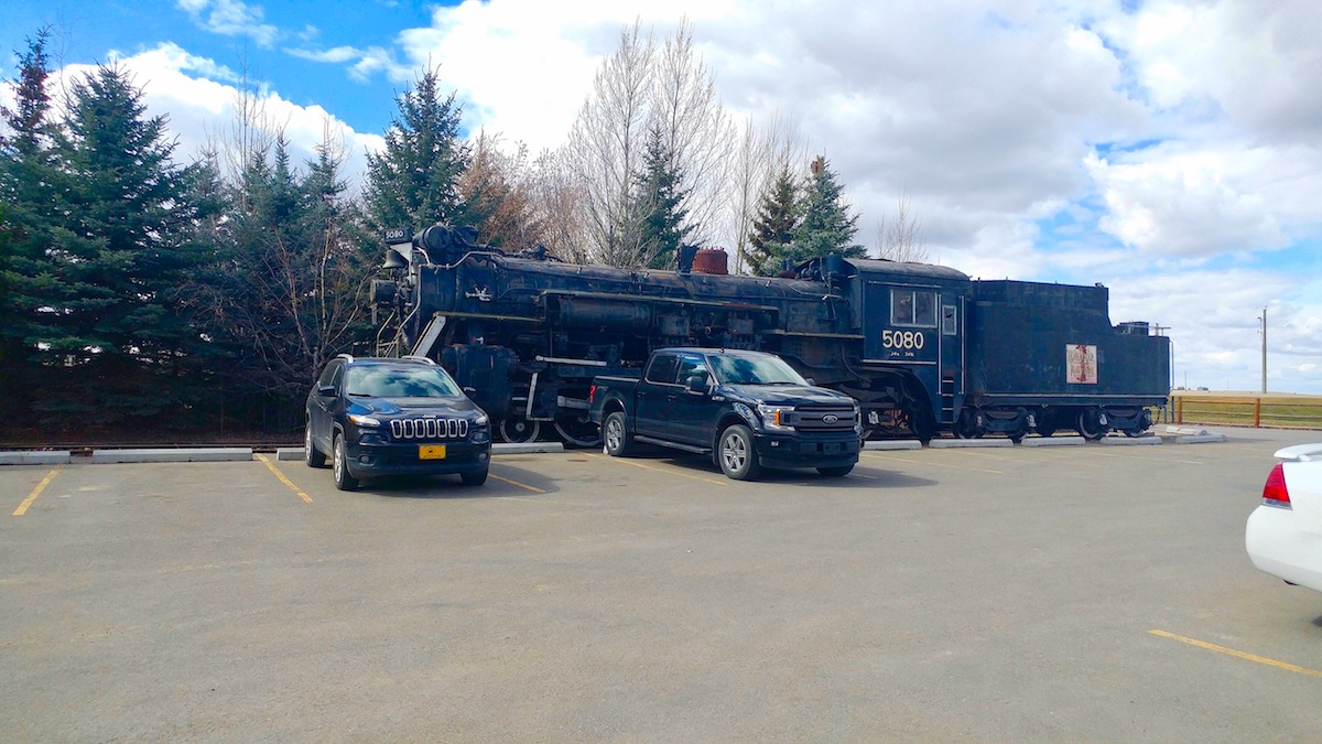

Outside the Boss's office at Aspen Crossing. Yesterday, April 10, 2019. Lots of discussion going on.

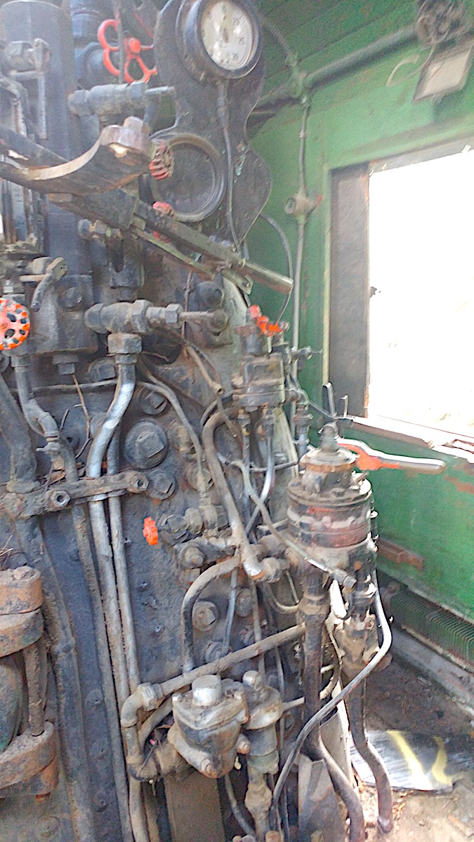

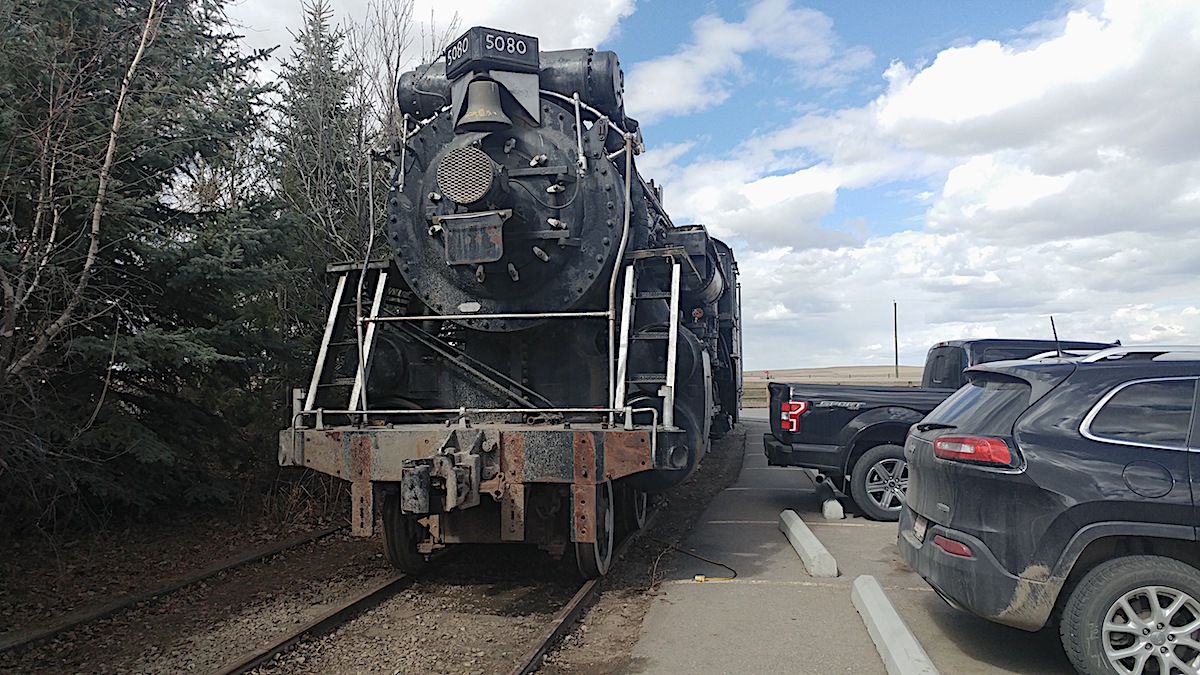

The appraisal process is well underway.
The pilot was removed to fit on the lowbed hiway truck.
Was very surprised to see the cab interior is remarkably well preserved.
Bits and pieces missing for sure.
But not trashed ...like every other Park Loco I've ever seen.
Jeez...look at all those gauges, and operating handles... still in place after all these years.
Looks like the locals really protected her.

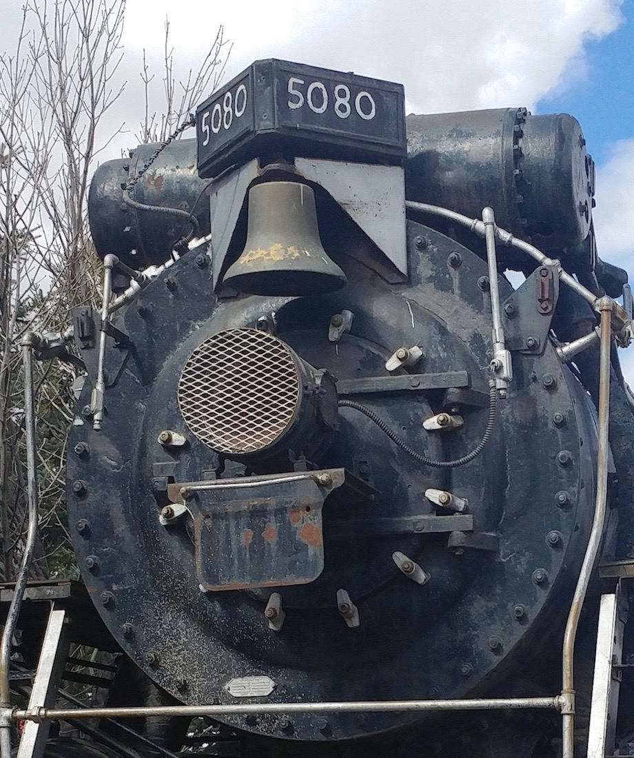

The headlamp is missing the front lense, and most of its internals.
Thus the metal screen.
It may be cheaper to buy a complete one, rather than rebuild the original.
Several people have suggested useful information, as where to buy one.
The preference is rebuild ...but these parts are not cheap.
But, as this is going to be the headlamp on an operating engine, decisions have to be made.

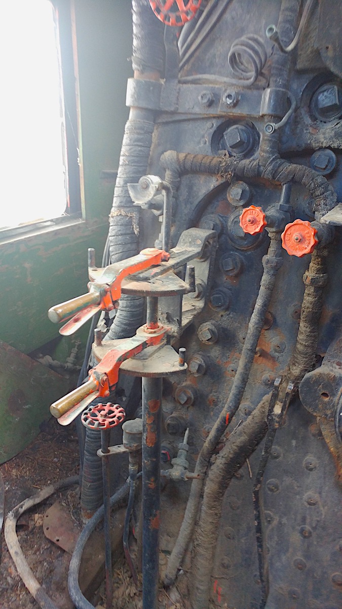

Congratulations on a nice acquisition. Now a somewhat related question... I'm not familiar with the double firing valve. What does the handle on each quadrant control?
 Post subject: Re: CN 5080 Update
PostPosted: Thu Apr 11, 2019 10:31 pm
Posts: 107
Old Smokey - We have a headlamp, marker lights, boiler gauges and a few other goodies- They are all sitting in my garage :)
Dennis - The top table is the oil regulating valve, the bottom one is the damper control.
