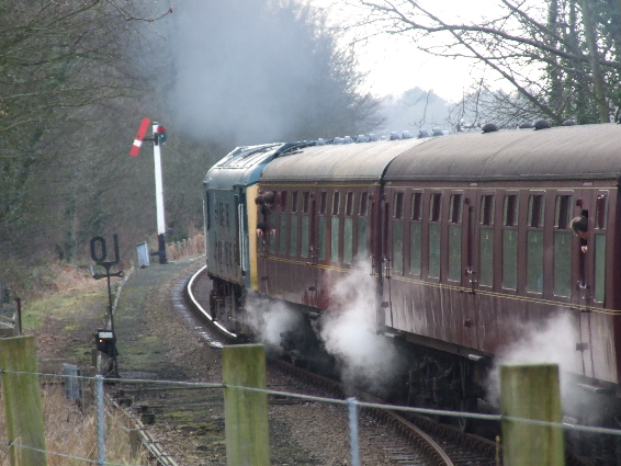

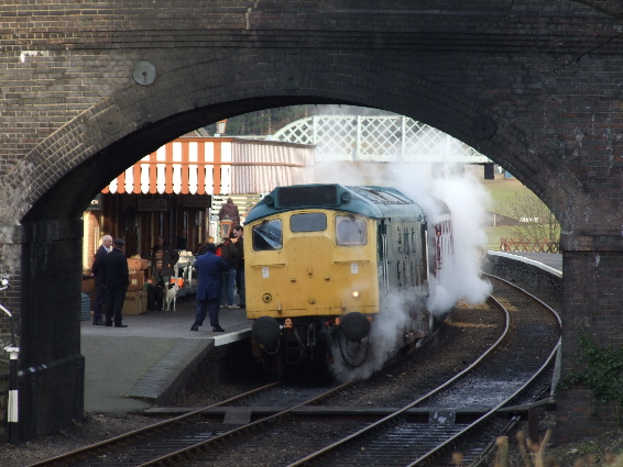

PaulWWoodring wrote:
From watching YouTube video, it appears that much of UK preserved mainline and tourist railway steam also uses steam heat.
Steam heat on the "real" railway lasted well into the 1980's here in the UK.
There are a limited number of preserved diesels which still retain operating steam-heat boilers, which can add to the "experience" on a cold day...........
One of the local preservation groups to me have announced this week that they have acquired a secondhand steam heat boiler to fit to one of their diesels to enable that function to be reinstated.
