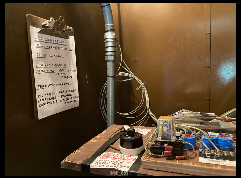

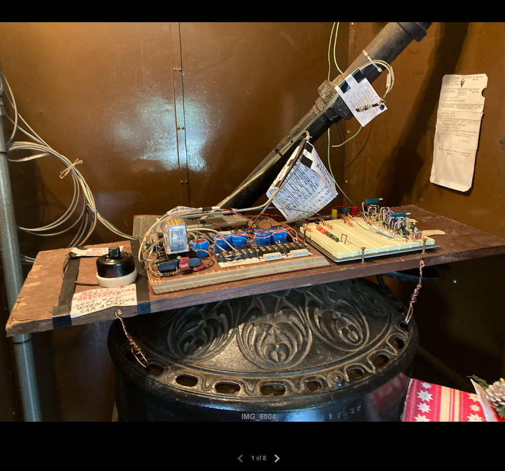

Bump. It has been a few years since there has been any more info on this.
My highly experimental battery charging control system is still in place on CSS&SB car 33.
Basically what it does is it senses when battery voltage drops below a certain threshold.
Then it charges at a rate of around 26 amps until the battery voltage reaches the upper threshold then it shuts off charging and allows the system to run on battery only until again reaching the lower threshold. The two thresholds (high and low) are adjustable via (2) small potentiometers. The lower threshold is around 36 volts and the upper threshold is around 40 volts. During normal running the typical cycle time is around 2 to 3 minutes. The small control circuit runs on filtered, regulated 5 volts and is basically
two comparators that drive 2 small PCB style relays. Those relays in turn operate a
larger 32 volt relay that has heavy contacts capable of operating the charging contactor
under the car.
Since making, installing, and testing this unit, I have come up with an even better one.
The better one has been extensively bench tested but as yet has not been installed on
a South Shore car. This improved version uses an ICL 7107 digital voltmeter IC along with some additional parts to "read" this voltmeter. The high and low limits can be set in
on thumb-wheel switches and there is a nice big red 7-segment LED readout of the voltage. This allows more precise control and also allows "on the fly" adjustments
to be made to the (2) threshold voltages.
The museum crews have used the simpler version which has been in place since fall of 2019 with good service.
Screenshot 2025-08-22 at 18-35-23 Regulator in 33.png [ 745.9 KiB | Viewed 15479 times ]
File comment: Experimental 32 volt battery charging regulator on top of coal stove in CSS&SB car 33.
Screenshot 2025-08-22 at 18-17-28 Regulator in 33.png [ 1.51 MiB | Viewed 15483 times ]

added a couple of photos
