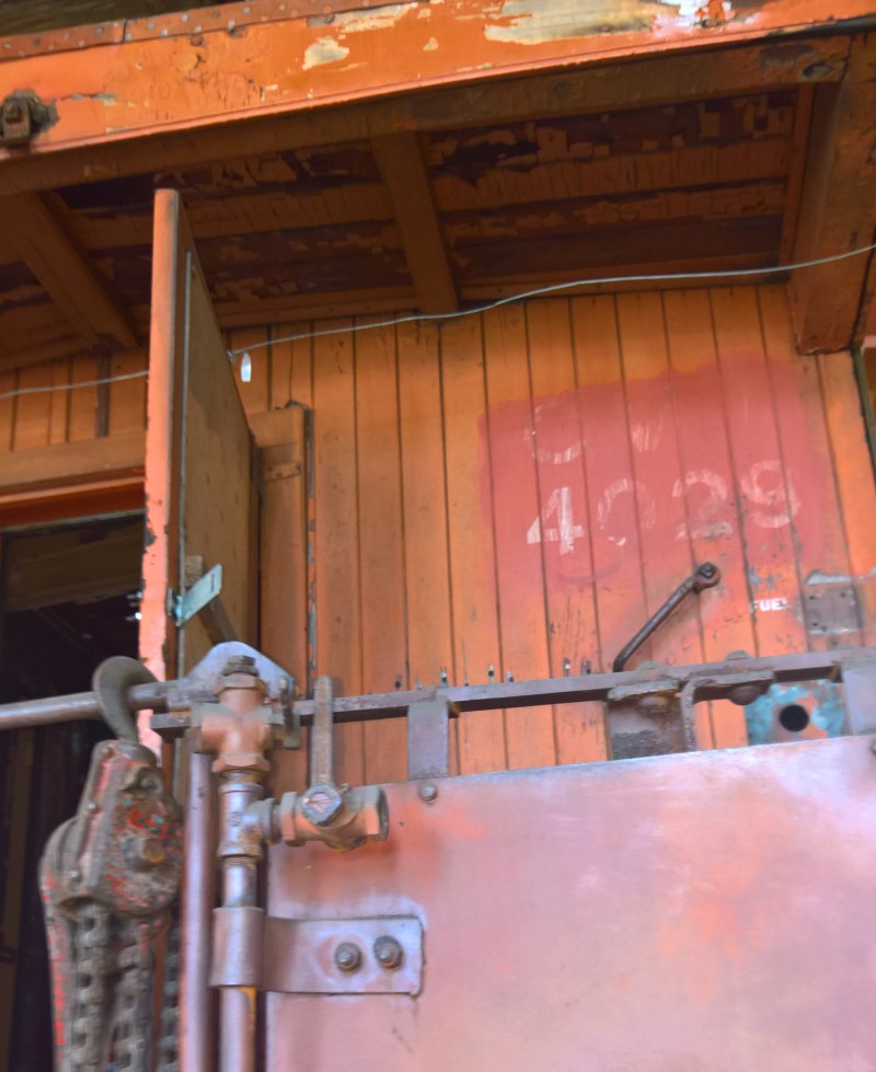

Here is the valve tree on the porche of the CV 4029.
There is the same valve set on the other end and on both ends of the CV 4052. Neither of them have anything after the valve, so I wonder if the top valve may have had a Peacock/Peanut/Banshee whistle installed, for times when the caboose was leading the train down a siding. One valve for a whistle and one for applying the brakes.

Rich,
I think you're right, although the whistle may have been shop made from iron pipe and a pipe cap, pretty common on some roads. I see the CV splurged with two valves. I've seen cabooses with just a single valve on the end railing. Above it was a pipe tee, with a reducer and street el coming off the side for the whistle, and a street el above that to vent the brake pipe away from the platform. If you wanted to blow the whistle, you covered the open outlet with your gloved hand, then used the valve to sound the whistle.

they indeed had a peanut whistle installed. at one point I think I have a picture of the ones that were on 4029 when mine was spotted next to it on MCRR I pointed them out to the then owner as being brass and he promptly removed them for safe keeping, but I guess they didn't go with the car, I have supplied two peanut whistles to the Shelburne Falls museum that were surplus to my collection. the lower valve is a dump valve.

CVRy didn't use the locomotive style whistle valves on the cabeese, they used standard car valves (same arrangement is on the 4052). Less parts to stock as the car knockers and car shop didn't have access to the locomotive shop's storeroom. Some railroads installed Sherburne Whistle which had a passageway and whistle mounted in the handle of the valve, but not the CVRy (either price or maybe they worried about it becoming clogged with ice or other debris).

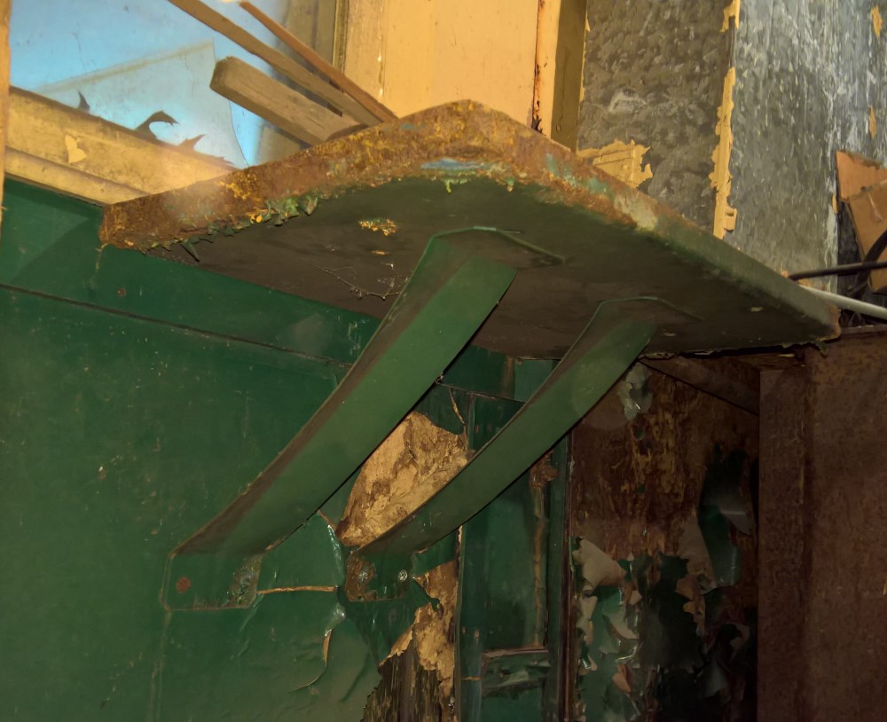

On the wall with the fold down table there is also a small table between it and the San-o-Cab heater/stove. It is 14.5 deep x 22 long, and 1/2" deep with 2 steel brackets underneath. Brackets and table looks to be made from 16-18 gauge steel.

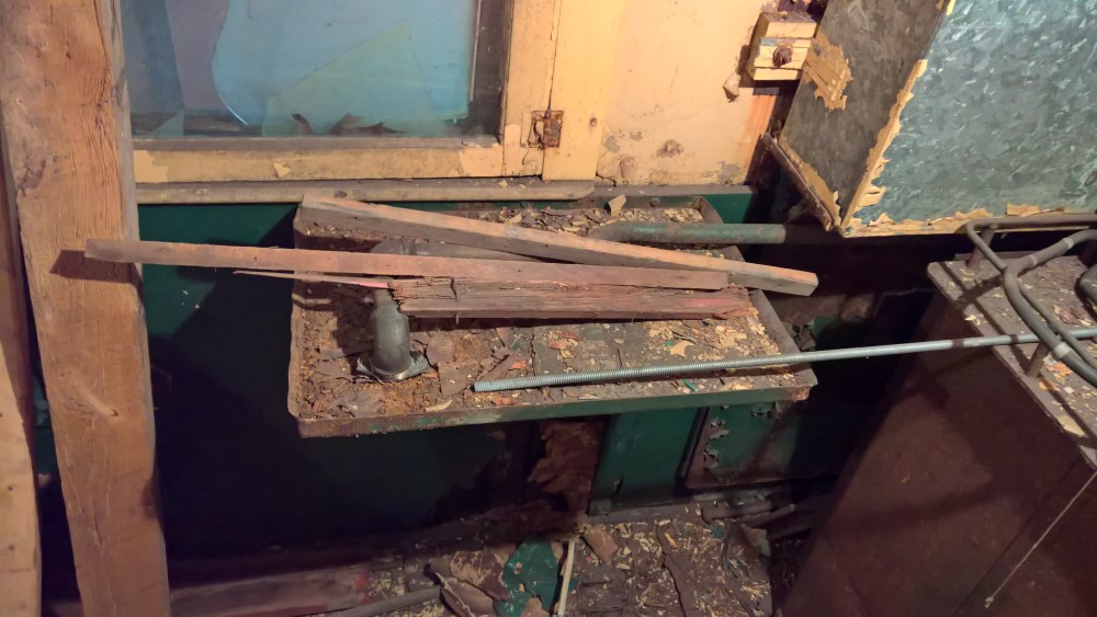

Pipe is not part of the table

Is that pipe on the table between the san-o-cab heater and table attached to the water tank? Our caboose does not have the masonite cealine, we do however have that smaller table but it dosen't seem to appear in the drawings Al.P lent us. I am guessing the drawings from Al are from the 60's or 70's due to the radio reference. While we do have a working B&M railroad stove we put in the caboose I thought this one was more original and would be better. The bord of directors diden't think the stove was important because of all the work and money that would require to install it when there is already a working one inside. I ended up buying the stove myself and restoring it myself in hopes it may one day go back in. I am trying to keep an eye one of these cabooses that is in a barn as a potential parts sorce. We still need the first aid box holder, luggage rack, desk, desk light, that valve back and spring, as well as some other parts.

pipe is not part of the table, tank or stove, it is just sitting there.
