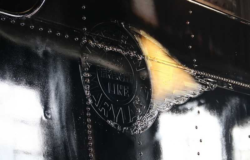

 Post subject: Re: First Fire Up - WMSR #1309
PostPosted: Fri Oct 05, 2018 5:22 am
Posts: 329
SteamEnthusiast4000 wrote:
aswright wrote:
1309 will be coming into service lettered for "Western Maryland", not "Chesepeake & Ohio". Eventually, 1309 will be lettered/numbered as Western Maryland #960.
Has this been announced by the WMSR? I'm just curious. If it has been, then, apparently, I didn't see that. If they do plan do to this, are they also planning to redesign #1309 (as best as they can) to resemble a Western Maryland M-1a class 2-6-6-2?
Can't comment about the number but the tender is masked for the Fireball......
Tim W.
