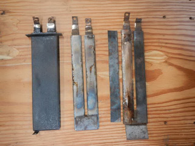

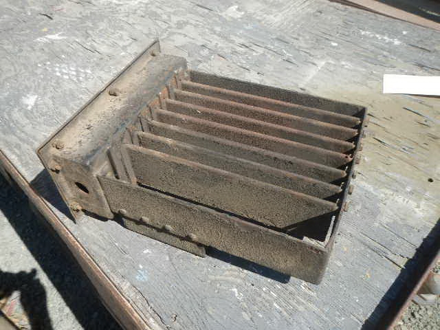

Here are photos of this type of resistor bank. The detailed photos of the resistance ribbon are from a failed element, hence their dirty brown color. The original material is silvery metal.
File comment: Resistor assembly
A "blade" resistor module, the element inside, and the resistance ribbon wrapped in mica:
File comment: A resistor element

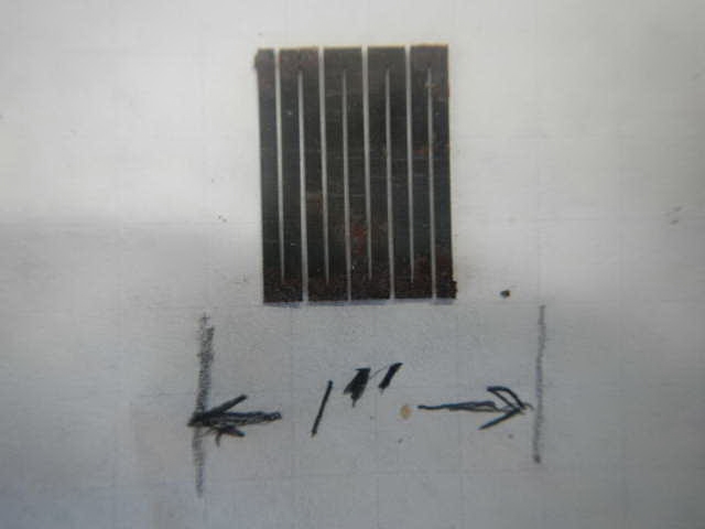

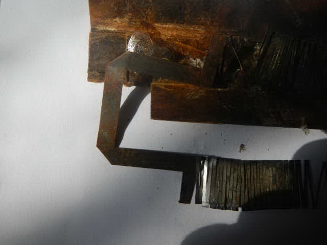

File comment: The middle of the resistance ribbon showing the resistance areas in each leg:
File comment: A section of resistance area of ribbon

Thanks for posting the photos. I looked at one yesterday and was curious as to the inside arrangement. The silvery lead material was warped in thick copper foil to avoid heat building at the terminal screws.
I’m surprised at how long and thin the actual internal resistive element is. Was the photo of a 40 Ohm unit? If so the material must have much less resistance than nichrome, may be Iron??
I too found it hard to imagine how to fix or sub the individual flat steel resistors. However after seeing the box they are in, if it were me, I’d replace all with new ceramic tube type resistors within the same box.

As to the color of the resistance strip, several years ago a new element was damaged in such a way that the end was pulled out of the sheet metal jacket. It was bright silver, just like a new nichrome or other high-temperature element material.
I think I'll send a piece of the material to a metallurgist for analysis (cut from a larger area at the end of the strip).
