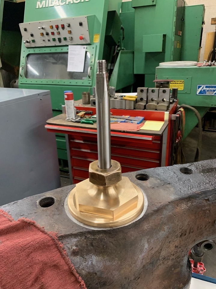

Seeing as their website hasn’t been updated and not everyone on here has a Facebook account, thought I would share the most recent update
“Update on our Princess! One particular valve on the loco has been a "problem child" since our last hydro and steam-up, which also has held up progress at several areas including another steam up. Thanks to R. Cunningham for providing a donation at the right time which covered most of the funding for the bronze material. We have tightened all the fasteners and the injector piping. More infrastructure work has been accomplished during the down time while the turret was being worked on. And sheet metal work and electrical work is continuing. She’s getting close now to next steam up but we don’t have a date yet. Exciting news is the tool car in Ohio is having the final touches done on the truck frame! If you would like to help us move the thermometer up on the GoFundMe, we would greatly appreciate it. All this can only keep going with donations and volunteers. The 2926 Crew thanks everyone for their help with this project! www.2926.us “
 Post subject: Re: 2926 is finally hot!
PostPosted: Thu Jul 04, 2019 10:43 pm
Posts: 545
Location: Canada
Our favorite machine shop, McClintic RDM Inc, started with an 8" diameter 100 pound piece of shiny bronze (purchased by the Society for a mere $797) and made it into a replacement bonnet for the main shut off valve for the steam fountain. They cleaned up threads, made a new stem for the valve and it looks great.
