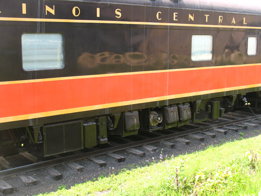

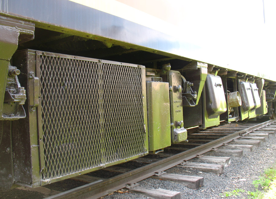

An article about the Blue Water Chapter, NRHS in Michigan in August 1992 TRAINS discusses the difficulties of maintaining a coach fleet and mentions having some ice-activated cars for which ice would have to be ordered if there is even a slight chance of it getting warm. It also said they were converting to diesel units adapted from trucks.
I believe this is a Waukesha Ice Engine and Enginator on IC 1906 @ Monticello.
