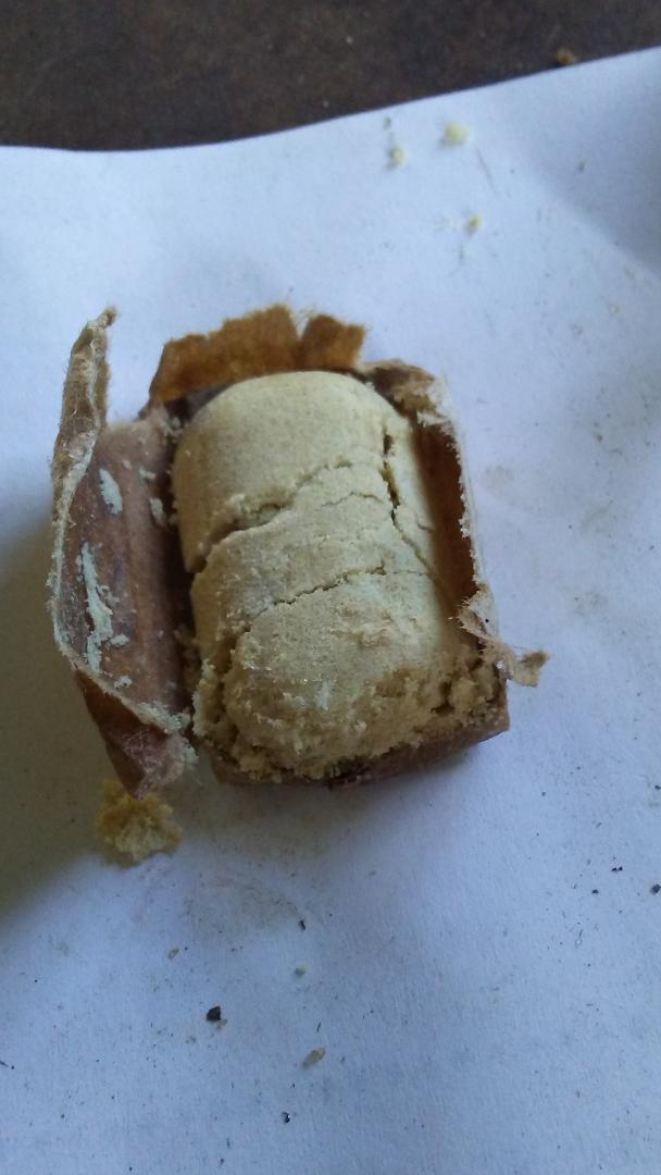

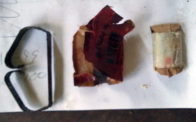

I sliced a torpedo open for show and tell here.
I cut it open with a stanley knife... the paper covering didn't hold it's shape, so be aware.
The "charge" is wrapped in paper, then masking tape around that...
I've seen them before, and those were solid... this one here was falling apart.. kinda soft. It didn't hold it's shape when I took the paper apart. Different composition than the old ones.
I took it outside and lit it with the flame of a propane torch. Video at the end here...
Took right off.. burnt for about 5 seconds and was consumed. I guess a torpedo's biggest drawback is flammability.... just like having fireworks laying around...
https://youtu.be/S7wvdYZ-Ogo
