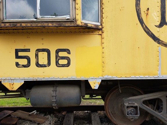

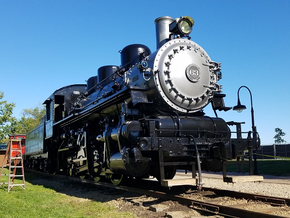

J. David Conrad used Sherwin Williams Steel-Master 9500 when he and I repainted the 0-6-0 in Gambier, OH last year. I looked through my photos and found that I took a picture of a can of paint to identify it. Although we used black for the 0-6-0 it is available in custom colors and I think that is what we are going to use for this project. This coating is a silicone Alkyd which is supposed to be able to retain its gloss longer than enamels.
I also had SW mix up a quart of all surface enamel to see how close we can get to the color working from a paint chip. I think what we came up with is acceptable.
