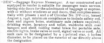

The five-pointed star was an A.A.R. requirement for Baggage-Express-Messager cars equipped with specific features. These were facilities for the messenger. These included work space, drinking water, toilet and lavatory.
In the back of the issues of The Official Register of Passenger Train Equipment is a two page document that was issued by the A.A. R. and entitled "Classification of Cars, Definitions and Designating Letters of Passenger Equipment Cars."
The Official Register of Passenger Train Equipment was published annually by The Railway Equipment and Publishing Co. IRC, this was the same firm publishing the freight car register. The separate Passenger Car listing came out in the late 1940s and continued to the coming of Amtrak. During some years in the late 40s and early 50s it was published twice a year.
I have scanned the two pages and here is a PDF of the pages,
AAR_Classification of Passenger Cars.pdf [375.67 KiB]
Downloaded 484 times

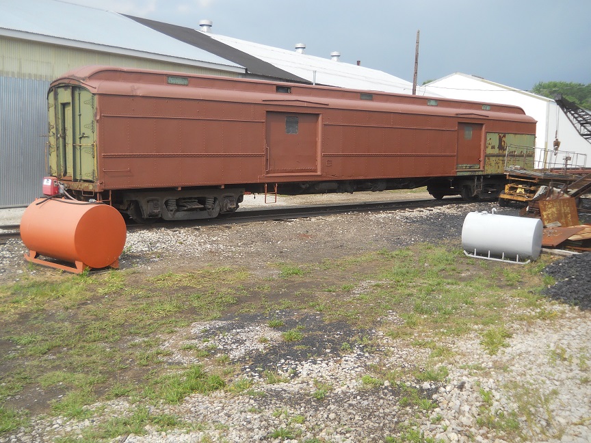

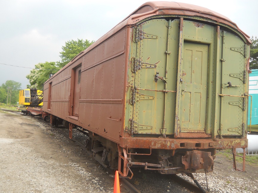

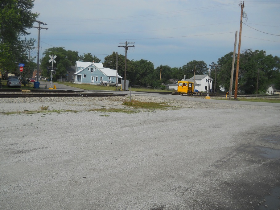

Mark managed to get some additional priming done on the car earlier this week (photos attached). Each Saturday morning before our first operations, Mark goes out with a motor car to inspect all of our trackage to be sure its safe to operate over. The first photo below shows his car coming to a stop this morning for the Mulberry Street crossing in a light rain.

Les,
With those end doors, does that not make this a horse car (for transporting horses?)?

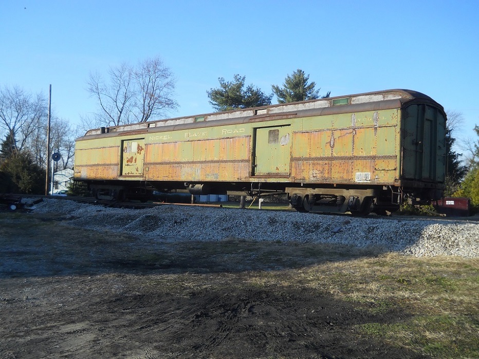

Olin -
Just above the belt rail on the end with those doors, the car was lettered AUTOMOBILE. I've added a photo but it is very hard to read that lettering. Perhaps someone might be able to enlarge it. Was the car also used to transport horses? It is certainly possible.

Are you making repairs to the metal or just painting? Good job!
 Post subject: Re: Nickel Plate baggage car #344 restoration starts at HVRM
PostPosted: Sun Jun 10, 2018 6:23 pm
train guy -
Mark says he is "not a metal man" and is strictly painting the car to make it look more presentable. The body problems will certainly have to be addressed eventually.
