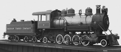

 Post subject: Re: Saginaw Timber No. 2 - Life After Mid-Continent
PostPosted: Mon Aug 15, 2022 9:48 pm
Last edited by Kelly Anderson on Mon Aug 26, 2024 2:42 pm, edited 1 time in total.
PostPosted: Tue Aug 16, 2022 9:02 am
Cheapest way to deal with thin and sharp flanges. Of course you have to do both sides.

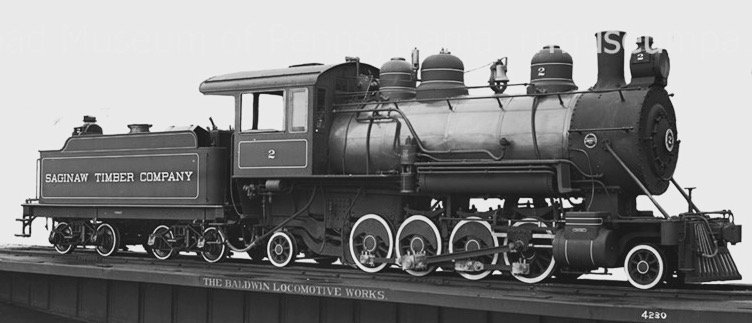

PostPosted: Tue Aug 16, 2022 10:15 am
Posts: 967
Ya Kelly it makes me wonder who was making the decisions to go back and forth and why? Was it a bean counter higher up in the office wanting to use flanged tires because they were on hand or if locomotive changed hands and new owners didn't feel they needed the blind drivers?
When we finally put the newly turned wheels, new bearings and one new Axle back under the frame {minus boiler} it was great to see how the running gear literally went around corners. Of course with half the weight missing it whipped around/through tight switches leading into engine house like a sports car. We just wanted to see how things rolled so it was a unique chance to be up close and personal to watch and listen closely. We did this during the week without a lot of onlookers watching. At that time few people involved at MC thought Skip would be able to get the #2 back together much less running. There was not a lot of warm and fuzzy support for this project. Until later when it was closer to steaming.
PostPosted: Tue Aug 16, 2022 5:32 pm
Posts: 540
Location: Minneapolis, MN
Kelly Anderson wrote:
Looking at a lot of photos of Colorado narrow gauge engines, I am impressed by how often a particular engine would go from having blind drivers, to flanged, and back to blind again sometimes over a span of just a few years.
The No. 2 came from Baldwin with blind drivers and never had flanges on the no.2 and 3 wheel sets. Because of the need to keep these wheels on the rails for traction, the tires were significantly wider than the flanged wheels.
