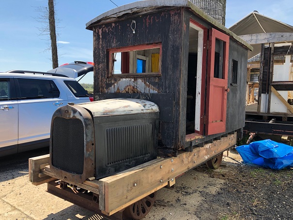

Thought a short update might be of interest. We started the Model A engine for the first time today after extensive work on it and even tested the clutch and drive train, all with positive results. Plenty more to do, but would probably be interested in passing it on to a new owner as we would prefer to keep our focus on the N6b caboose and Trenton 288 trolley. Do have some video of the action but too large to post here.

Neat-O. I see you "improved" the front treatment with a model A radiator shell and hood. Now that I'm looking at the other pictures (for some reason tonight the dial-up is loading the pictures) it looks like he just jammed the T driveshaft into the A transmission. Usually their is a two-piece cap that bolts on there, providing a seal so you don't loose lubricant out of the U-Joint. That is a T driveshaft end. Think if I were going to make this a usable rig, I would look into putting an A torque tube end on the differential so it could be nicely sealed up. This, of course, would take a little "shade tree engineering" but not really difficult.
I would imagine changing the gauge shouldn't be too difficult, and it WOULD look neat on the WW&F.

PS, the reason the hood and radiator shell don't match up is that's a '28-29 shell and a '30-31 hood.
Actually we do have the proper radiator shroud for the hood, but it was the wrong shroud for the radiator that came with the unit. A new radiator is probably in order at some point and would be purchased to match the later shroud/hood. The real purpose of the hood it to offer some weather protection for the motor, we were not overly concerned with fit at this point.
In truth, the goal has been to stabilize the car, protect it from the elements, and to get the motor running. Quite happy with our progress to date keeping in mind our focus is on an N6b cabin car. We have not looked at all into how the drive shaft was installed, but would like to learn more about the rear wheels which are rather hard to study. We can read “Works” and Baltimore, Maryland on them. They are a beautiful cast wheel.

Well, it's just my opinion, but a 28-29 hood (used) would probably be cheaper than a new radiator, and would visually look more "Period" on the Railtruck. (you could probably sell the '30-31 hood to help finance the swap--yes, I am CHEAP!)
Can't help you on the wheels, but they do look neat.
The neat thing about it being a Railtruck is that the radiator shell could be painted, as the commercial shells were. Big savings over nickel plating it ( the car shells were nickeled). '30-31 commercial shells were usually painted, but some were stainless steel for the fancy trucks, and the cars were all stainless steel. (Well, except for the painted inserts on the '31 shells)

In truth, it needs a new radiator anyway, so that is the direction we figure on going. The current radiator is only on a temporary support. The proper steel cross member is not yet installed but will be once we have the correct radiator in hand.
We have been focusing on the motor, so have not really looked at much else. Unless it finds a new owner, we plan to do some incremental improvements but then probably replicate it, although not sure if it would be 2’ or 3’ gauge. Whatever the case, it is a longer term project.
