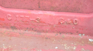

I have a closeup I took of the stamp on the steps. Hopefully this will help a little.

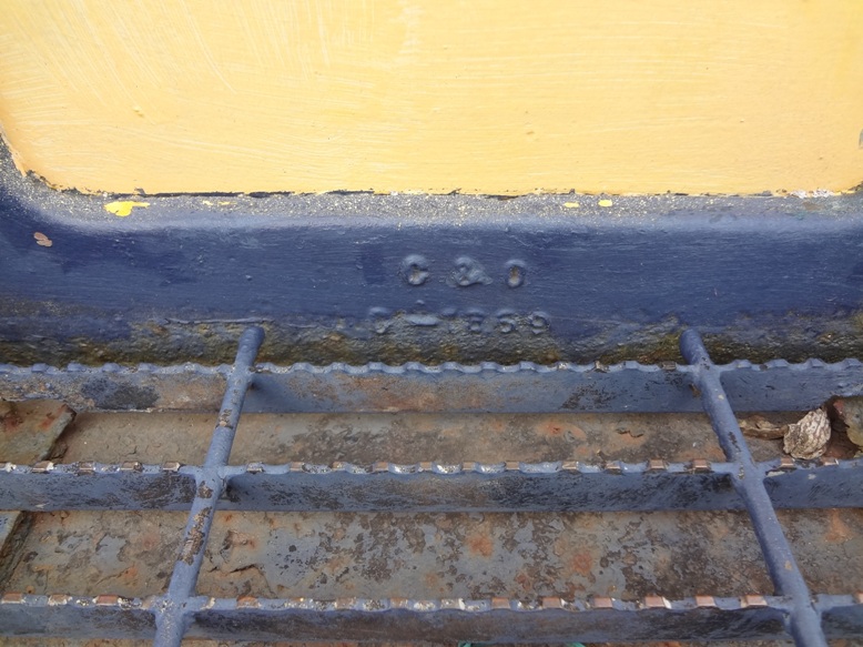

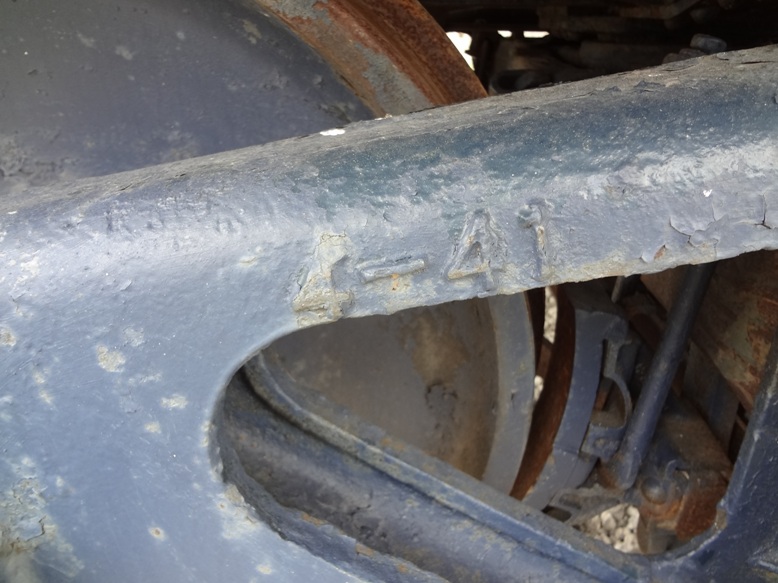

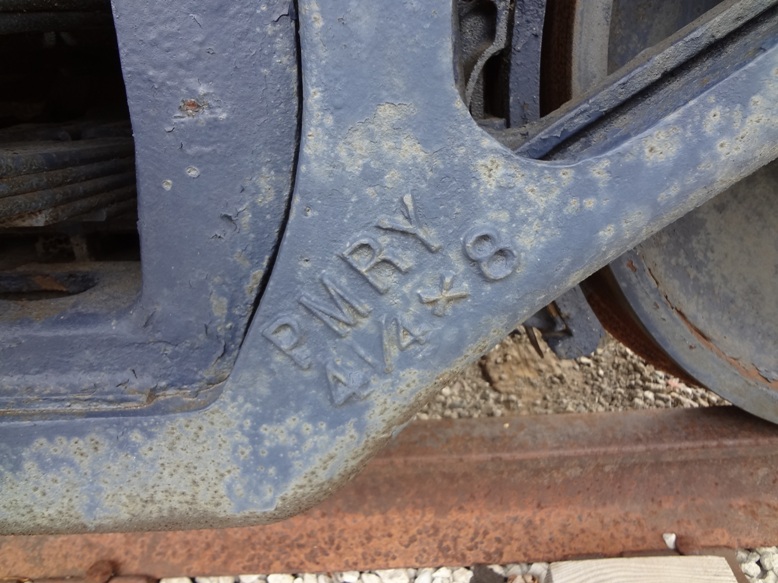

Filling in some additional puzzle pieces for reference related to the mystery caboose,
I walked over to the local museum that displays C&O caboose 900124.
http://www.mlive.com/news/saginaw/index ... es_fa.html
The step on this particular caboose is also identified with a C&O casting part number
but the caboose trucks are marked Pere Marquette with a date of 4-41.
(I've often suspected this caboose is not as old as the stated 1941 build date in the above article, but this
hunch doesn't relate to the discussion at hand.)
The brake wheel(s) on 900124 do not match that of the mystery caboose configuration nor is the end window placement the same.

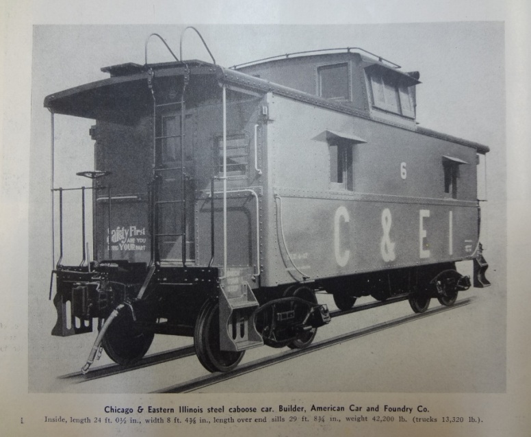

American Car and Foundry appears to have built the mystery caboose style for other roads besides C&O / PM as clearly denoted on
page 276 of the 1949-1950 Car Builders’ Cyclopedia.
But tangling things a little further, the caboose in the car builders’ photo is stenciled with a date built of 1947.
The cyclopedia photo shows the same brake-wheel arrangement as the mystery caboose but the end window placement does not match.
Interesting mystery with clashing construction details ; )

The PM-stamped trucks are not unusual on a C&O caboose, as a lot of C&O cabooses were overhauled at the former PM Wyoming Yard shops (Grand Rapids, Mich.), and trucks were freely mixed over the years.

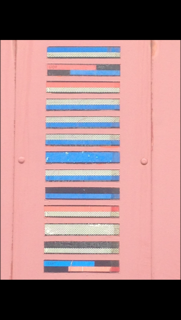

I just paid a visit to the caboose and snapped a closeup of the ACI tag.
Thomas
 Post subject: Re: Mystery Caboose
PostPosted: Wed Apr 11, 2018 5:32 pm
Posts: 283
Tag says C&O 90002.
G.
PostPosted: Wed Apr 11, 2018 6:41 pm
TrainDetainer wrote:
Tag says C&O 90002.
I don't have roster information that might include renumberings, but if that's right, it could be one of the cars from the initial order of 1937.
That would make it a bit of an oldie!
