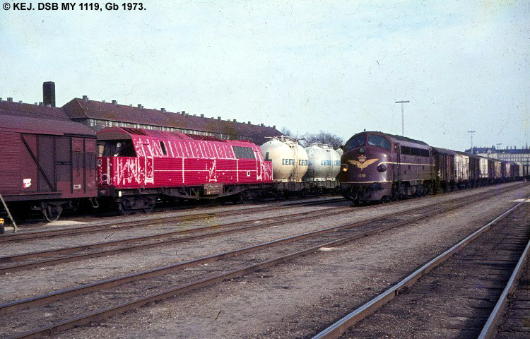

Don't forget various off shoots of the bulldog nose was used for overseas locomotives, and often on double ended units such as the Victorian Railways B class in Australia and the very similar DSB Class MY and similar types in Europe.

The DSB MX and MY (later MV) class locomotives were built on contract with GM (EMD), hence the similar apperance.
File comment: DSB MY 1119 in the foreground with a shell for another GM product in the background, a DSB MZ, which didnt have the characteristic bulldog nose.
