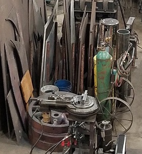

Hi
I have a question for the Strasburg Shop, in the last photo showing the entire shop, I saw a set of drivers by the welding and steel equipment, which locomotive to they belong to? Thank you.
