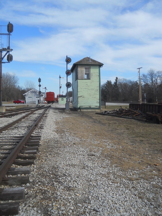

I manage to post photos directly to the board. As an example, here is a photo I took yesterday at the Hoosier Valley Railroad Museum.
Fix it up, clean it up at Hoosier Valley 3-10-18 014.JPG [ 295.48 KiB | Viewed 8106 times ]

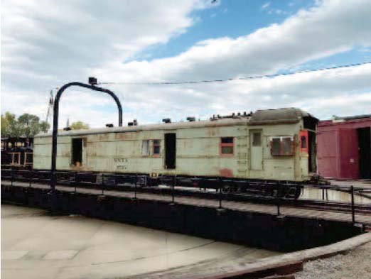

File comment: CBQ 9735 at MTM <--- Caption
