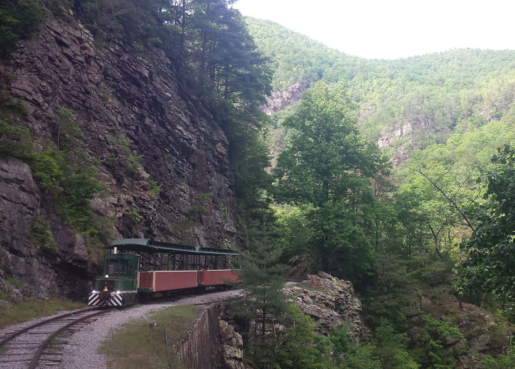

Posts: 113
Location: Wadsworth, Ohio
Both of the "new" Dry Gulch cars have now had couplers installed and the brakes re-installed & tested. A clearance trip was taken today to test the brakes & check clearances in the tunnels for both cars (one turned out to be several inches wider than the other). No issues emerged & the test was a success. They are now cleared for use during the summer camping program. When time permits, painting and other possible upgrades will take place. Photo by Mark Milbourne, camp staff.

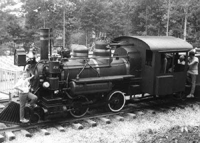

Some other details, the text with the newest photo, as written by poster Dennis Larrick:
36" gage Crown Metal Products 4-4-0 #3, built for Pioneer City in Davie, FL in 1966, looks out on Tunnel #2 of the old Tweetsie grade at Doe River Gorge, Tennessee. The former oil burner is being converted to coal. The restoration group is blessed with volunteers. Randy, a professional sign designer, donated the Baldwin-esqe work on the tender, and Jerry, a professional woodworker, is donating the historically accurate red oak cab based on pictures of Dan Markoff's "Eureka". A local fab shop built the Radley Hunter stack waiting on the pallet. Please understand that in today's society the public cannot be permitted to wander an active youth camp when kids are present, but the staff is friendly to serious fans who make proper prior arrangements and who are willing to contribute to the project in some way.
Hrrumph, why a Radley-Hunter stack? A cap stack, a small diamond or a cabbage head would be better.
Oh well, not our call.

None of the 36" Crowns were ever built to burn coal, Monroe built those boilers to be fired with propane. I don't know if there is going to be enough grate area to maintain steam using coal.
