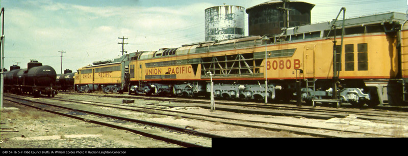

UP 8080 the Coal Turbine Electric.
Worked but they could never stop the pulverized coal from abrading the turbine blades.
A UP Alco PA for a Cab and a ex-GN Electric for the turbine.
-Hudson

Remember, it didn't just have to work it had to be cheaper than diesels. Th BN tried a coal dust/diesel oil mix in a diesel engine but had the same problem with grit the UP turbine had. Diesel's original engine was supposed to run on coal dust but oil worked much better.

The 80/8080 never completed more than a small handful of successful trips and never went west of Cheyenne. The crushed coal had little to do with it, as the coal itself never came in contact with the turbine blades. The resulting fly ash did, however, and it abraded the blades. About the only good thing about that was that it wore the blades fairly evenly, rather than creating an imbalance condition resulting in a catastrophic failure.
