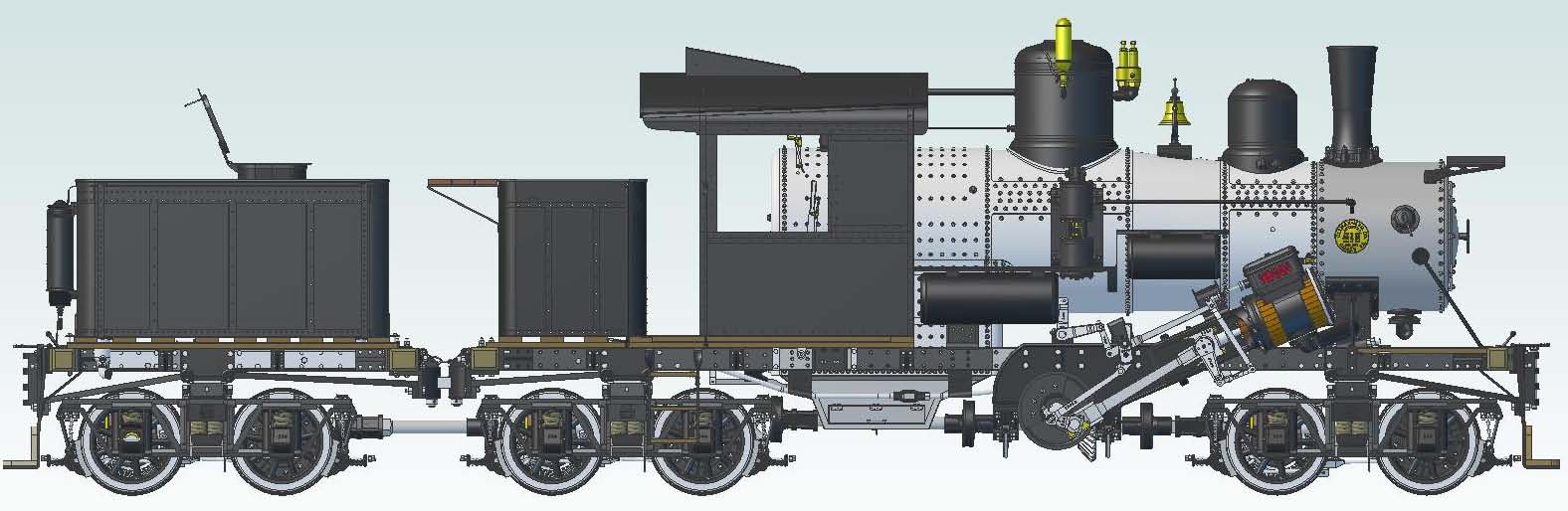

Color rendition of 1551 as of 2019 but with the 1919 Union Iron Works Boiler and Shay Stack mounted by D&GVRR.
The 2.5" Safety Valves & Whistle are generic designs to illustrate location.
The Cinder Dump (on the bottom of the Smoke Box) and the Poke Hole Covers are typical to Climax but will probably not be added by D&GVRR. Ash Pan is approximate pending further measurements. Whether Builders Plates will be installed is unknown. I am aware of the location of one of the originals but I do not know if it will become available and it does take two.
The restoration of 1551 may be delayed due to frost cracks in the Steam Chests.

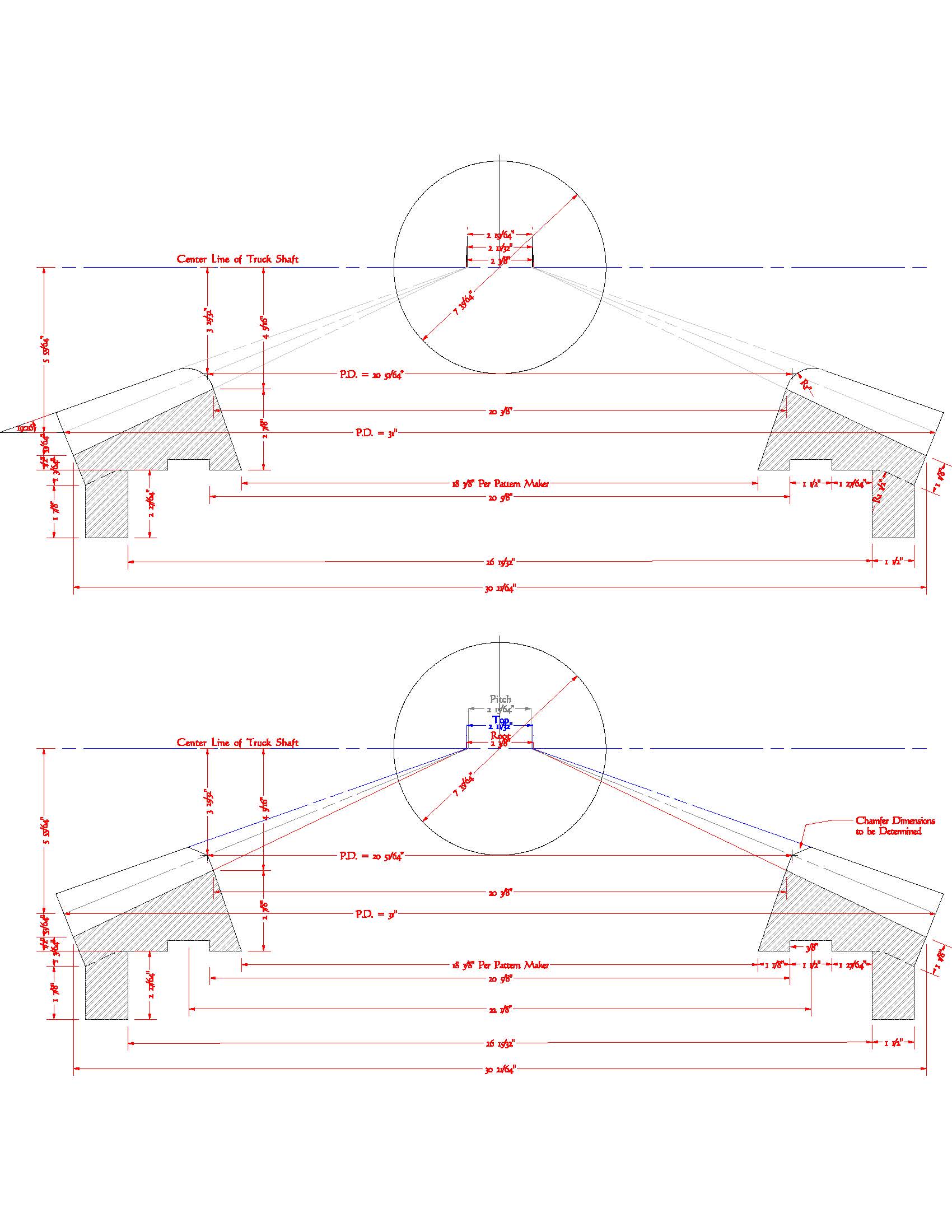

I'm going purely by what I've read, not what I've seen here, but my understanding is that the original Climax patent going back to Charles Scott involved the special design of the helical gears between the axles and the main driveshaft, and that the original foundry master was actually handcarved out of wood and 'tweaked' until it worked. It's reputedly 'the part' in a Climax design that made it work, and was carried forward to even the latest designs. Everybody else's gear systems were relatively straightforward, his spur/helical were somewhat of a bumblebee that actually worked.
Were you able to document and draw that?

John Lewis provided me with copies of the original Climax drawings of the F509 Ring Gear, F217 Pinion Gear and F221 Countershaft/Crankshaft gear from which I developed the 3D CADD drawings with the help of an engineer in Denmark named Bent Gobel.
The drawings were quite detailed. I created the following cross sections from those drawings mirroring the half side show to reflect both sides, and using the newly cast and old ring and pinion gears at Cass to confirm the result.
The top section is per the original Climax drawing with the filleted gear tooth and the bottom is the Cass gear with a chamfered gear tooth as done by the pattern maker Wayne James. I have permission to share the info provided by John Lewis but not the drawings themselves.
Note the difference in the Called Pitch Offset in the Center of the Skew Circle in the two drawings. The original Climax drawing states 2 19/64" (Top Drawing), however, using a CADD program and the stated Offsets from the Center of the Line Shaft and Center of the Gear, my CADD program reports the Offset to be 2 15/64" (Bottom Drawing). A small difference but 4/64" = 2/32" = 1/16". Which is correct (if either) I do not know.

Note: The Circle is identified as the "Skew Circle" on the original drawing.
Attached is a 3D pdf of the final result.

OK, not sure where the applause button is, but I'd hit it.
That's really nice work. That's the secret sauce and the Original Recipe, all in one.
