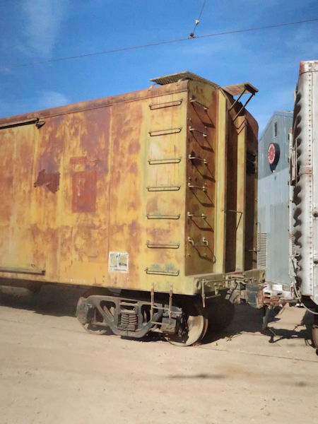

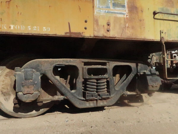

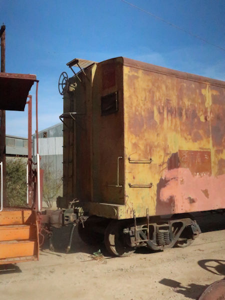

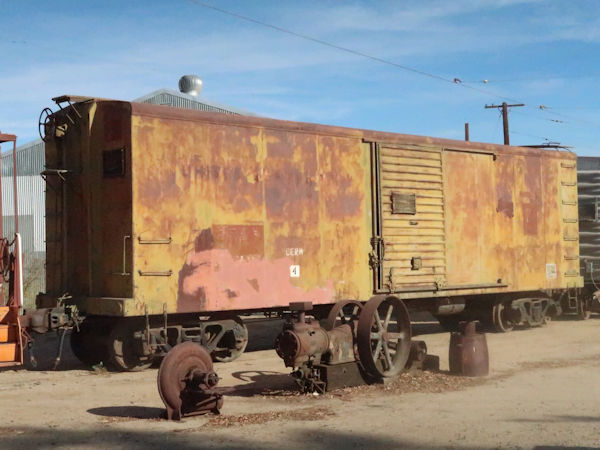

When this thread was first posted I recognized that Orange Empire had two of these cars. Here are photos of one of the cars. I took the images back in early December -- and then forgot about posting them.
Both cars came from an automotive tire dealer and before that they were owned by the US Army. One of the trucks under this car indicates that it was built for the C&NW.
File comment: close-up of one end
File comment: the other end
File comment: this truck has C&NW cast on the side frames.
We also obtained from the same location two other box cars that are ex-USA ex-D&RG cars. The D&RG information is from the brake lever plate on the underframes of those two cars.

Thanks for the photos of the car that Orange Empire has stenciled as "OERM 4". The confirmation of the trucks as having C&NW cast into them, is also very welcome. Also interesting is the info stamped on the car body just above the truck which appears to read KTOD 5 21 59. It appears some of the lettering might be just outside of the photo to the left. Perhaps the letter RP in front of the K? Making this a Repack (RPK) location and date? I admit this is strictly speculation, and perhaps those letters do not exist. That date however, kind of "ties in" with the date on the Maumee car if the unclear last two digits on THAT car is 58, for 1958. The cars both perhaps sold second hand around that the late 50's. Again, speculation.
Would be interesting to know if the underframe of "OERM 4" also has some private car information on it, as the Maumee car does, and if so, what that identification might be. Neither J3a-614 or Dennis Storzek could quickly identify the DROX private car reporting marks, but some future digging might eventually yield some results. Hope springs eternal!
