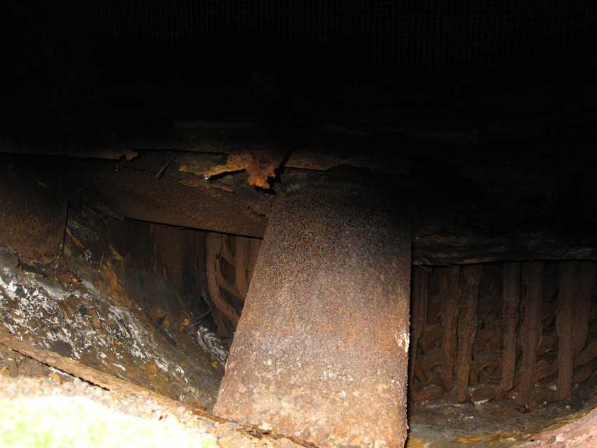

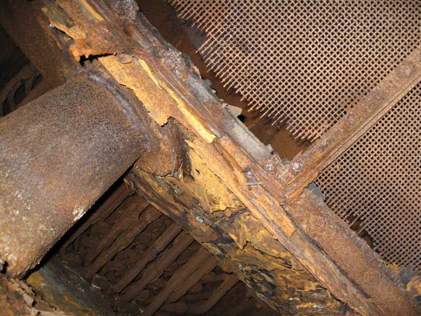

As for 6218's stack, there is a plate inside the stack about 3" deep. Not sure if it was originally welded in place, or just siliconed, but at any rate it leaks like crazy, and the recessed design specifically allows water to pool in, and of course leak into the smokebox. Compare this to 6167 which has a sheet of copper that was formed over the stack. Not only is it quite strong, but it kept 6167's smokebox perfectly dry.
6218's smokebox on the other hand is a horror show. When I visited her in 2007, I was able to fit the lens of my camera into the hole in the smokebox door, and the corrosion damage is extensive! I wouldn't be surprised if this has affected the structural integrity of the bottom of the smokebox, where it is bolted to the cylinder saddle, which would possibly rule out lifting it via the smokebox (the traditional way of lifting a locomotive in the backshop, and how we lifted 6167 back in 2009), should someone need to move her.
As an added bonus, I wonder if water entering the smokebox may have also been able to find its way to the cylinders. At any rate, all of the plugs and other fittings on top of the cylinder block have been removed, so it is likely that water has been getting into the valves and pistons as well.
Yes, the original caretakers did attempt to weld the hole in the smokebox front closed, but obviously never bothered to figure out how water was entering, and sure enough all that water just rusted right through again.
Here are the photos I took of the smokebox in 2007.

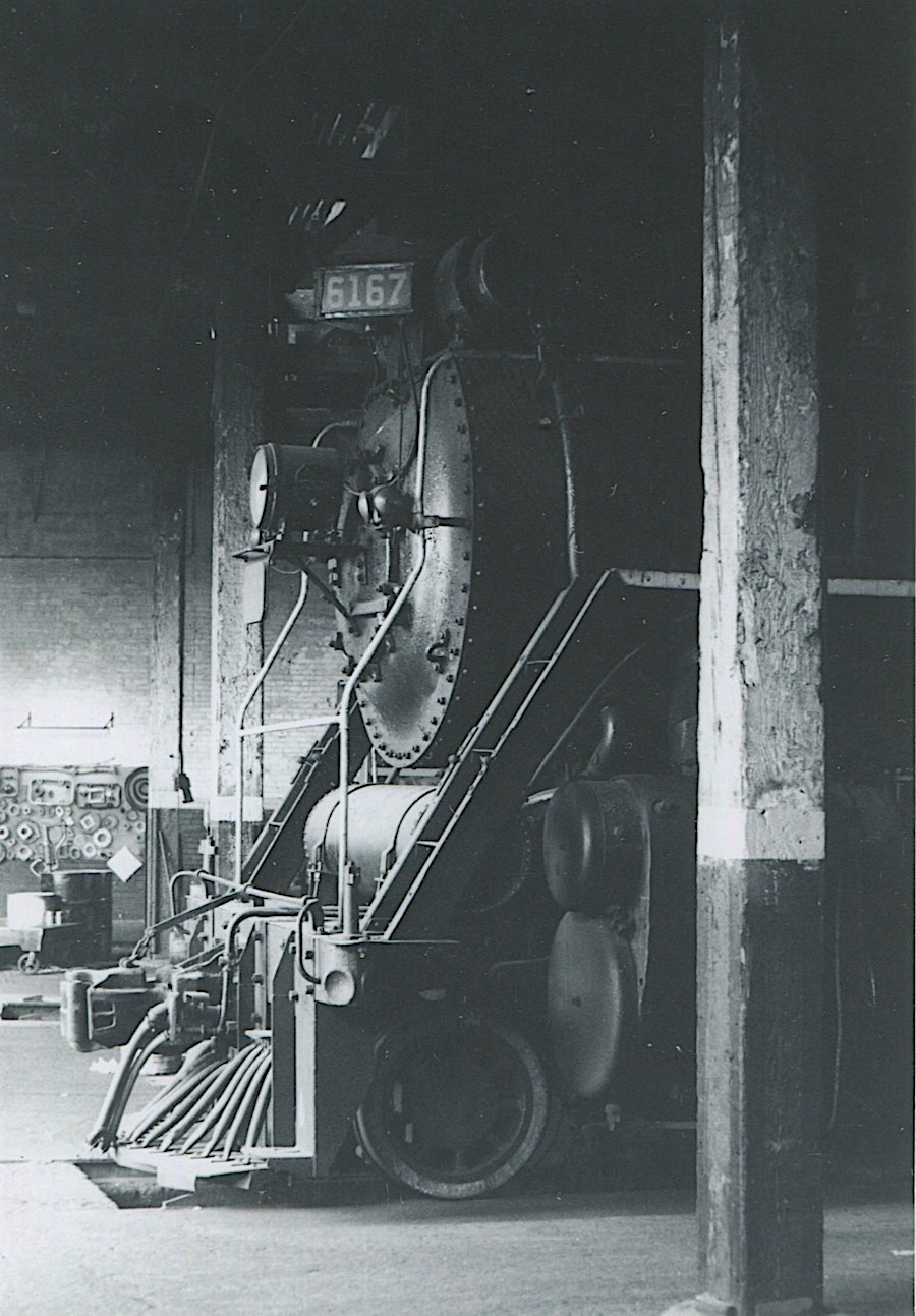

From what you are saying 6167 would have been O.O.S. for about a year when this shot was taken.
Any idea about what those bits and pieces hanging on the wall are all about.?
O.S.

 Post subject: Re: Former CNR 6218
PostPosted: Sun Oct 22, 2017 8:45 pm
Those bits and pieces look like Alco 539 engine gaskets.

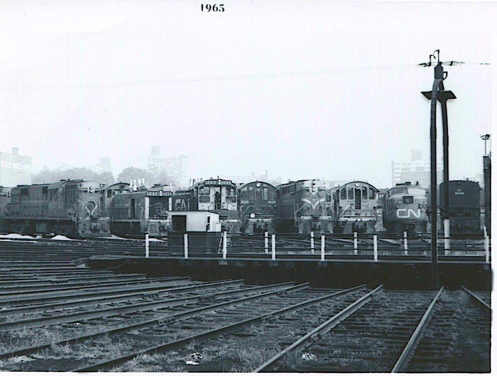

Howard...
Me being a steam guy...which one of these engines used the 539 engine.?
PostPosted: Sun Oct 22, 2017 10:52 pm
4th and 6th from left. Round-roof, end-cab Alco switchers.

Transparency - My unsolicited advice mirrored a great deal of the recommendation offered by the group assessing the 6218 and the caboose. The company that made the recommendations showed insight and a practical, intelligent approach to bring her back from her deteriorating condition. They deserve major credit for their report. It's up to Fort Erie to take action and use this plan to saved a great locomotive.
FWIW, I think the caboose is in salvageable shape, whereas the "pros" do not. 6218 is not a total loss, but requires some realistic, funded attention. The addition of a roofed weather shed and dusk to dawn lighting, along with a fence, would be the beginning.
Capping the stack is absolute. Replacing the heavy steel face of the rusted out smokebox areas should be done by a professional welder, and not by "Bunky's Auto Radiator & Tire" company. All moving or once moving faces and parts should be regularly greased and oiled. Paint isn't good everywhere, but it's better than open exposure.
Lots of cosmetic repairs are required, but maintaining the integrity of the locomotive as it was in service is critical.

Howard P. wrote:
4th and 6th from left. Round-roof, end-cab Alco switchers. MLW RS-18's, too. There were a lot of 8500 (S-13's from memory) series MLW switchers assigned to Spadina to do the large amount of passenger switching required between Union Station and Spadina Coach Yard, just west of the roundhouse. At that time, road power traveled light to and from the station and MLW switchers shunted the consists. The older MLW switchers were used to service numerous area industries and freight sheds which with a few exceptions, are long gone.
