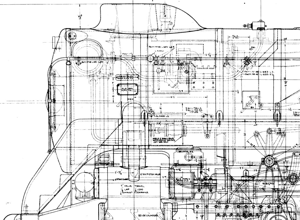

One last thing on the topic, attached is part of the CPR Royal Hudson erection drawing showing the location of the superheated whistle. It can't be operated by hand...
