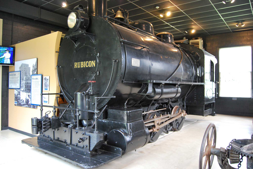

0-4-0 Fireless Steam Switch Engine NCR Dayton - This engine was built in 1913 by Lima for National Cash Register’s Dayton, Ohio plant and is a fireless steam engine requiring a steam “charge” from an external source (aka “fireless cooker.”). It was donated to the Museum in 1965. Status: In storage
I have no idea where this is hiding at.
Not "hiding."
Carillon Park, Dayton, Ohio--in a separate building from their "Transportation" roundhouse, used to display an exhibit on the 1913 Flood and NCR.
Photo by yours truly back on April 14th en route to IRM, Green Bay, and other places.

There were actually three of these little teakettles. One survives in Dayton Ohio(the Rubicon) one survives in St. Louis (the South Park) and the third I believe is at the Southeast Railway Museum (the Dayton). These were the first fireless cookers built in the US.

Lima
1087-1 1087 11/1909 Std 18x18 36” - - - Stored Steam 38-ST 38T 0-4-0F
First Lima Fireless Steam Locomotive
National Cash Register “Rubicon” Dayton, Ohio
Dayton, Ohio Music & Arts Foundation
Display - Carillon Park- Dayton, Ohio
1139 1139 12/1910 Std 18x18 36” - - - Stored Steam 38-ST 38T 0-4-0F
National Cash Register #1139 “South Park”, Dayton, Ohio
Rebuilt -- 1955
National Museum of Transportation, Kirkwood, Tenn
Display
1310 1310 6/1913 Std 18x18 36” - - - Stored Steam 38-ST 38T 0-4-0F
National Cash Register “Dayton” Dayton, OH
NRHS-Atlanta Chapter –for-
Southeastern Railway Museum, Atlanta, Ga
Gwinnett City Ry Museum, Duluth, Ga
Display
