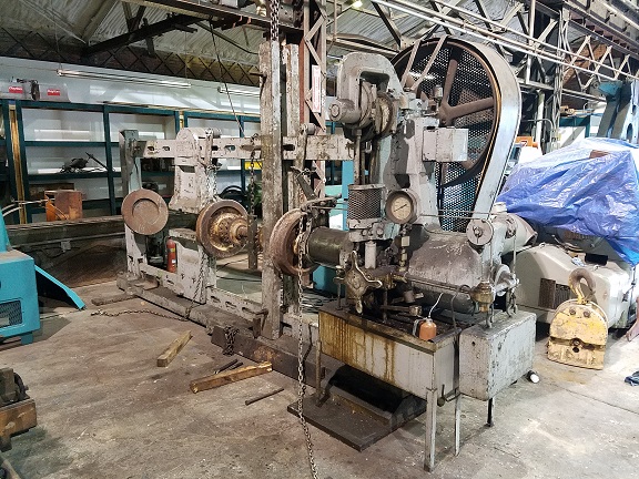

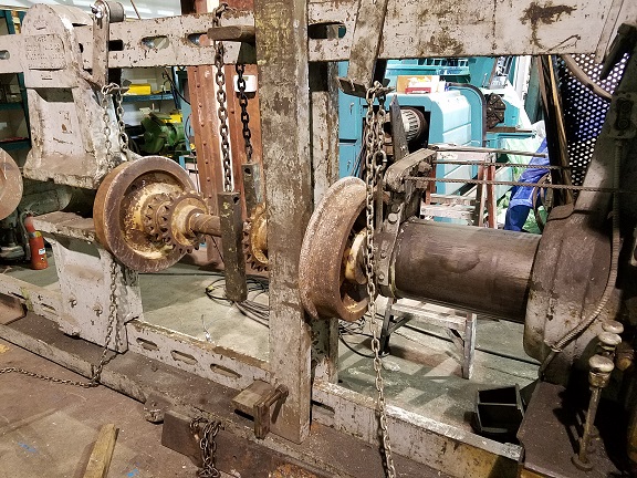

Using a Niles Bement Pond wheel press originally built for the Alco Richmond Works, I pushed the wheels off the axles in preparation for machine work to convert to 24" gauge.
