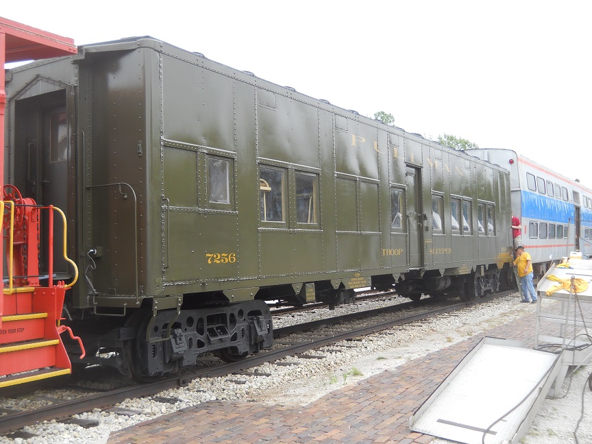

To Kelly Anderson -
At Hoosier Valley yesterday, we decided to give the procedure you mentioned in the first entry in this thread, a try. Basically we followed the first 3 steps as you outlined (like the Strasburg, we have not yet done the 4th step). Our Pullman Troop Sleeper #7256 looked quite similar to Strasburg's P&R #10. The results of our efforts are shown in the attached photo. We shall see how the car holds up.

Les,
That looks really good. What was the original paint (mfg and type)?
How did your crew apply the linseed oil soap, long handled brushes or hand-held rags? Any additional tips to offer on this process?

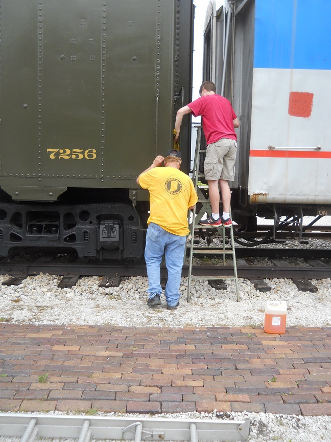

Howard -
To answer your SECOND question, we used long handled brushes to get to the upper portions and hand brushes for the areas below the windows. As for the original paint, I'll have to check and get back to you on that.
Additional tips? We found that the "Dry wipe of the surface" mentioned in Step 3, left slight marks, and decided to just omit that effort since the surface was dry by that time anyway. BTW, the ends of the car were not really faded as they were not in the direct sunlight, but we decided to apply the raw linseed oil to them (step 2) to match the rest of the car. We did not do Step 1 for those ends. In the photo attached, Lars Henderson is up on the ladder with Tom Rainford doing the lower section on one end of the car.
