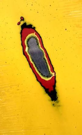

As for the paint. There are a number of people who study paint, both by sampling on historic buildings or artifacts, or by researching railroad records, or by studying paint technology, locating and reviewing old paint catalogs or sample cards or even the paint and decorating aesthetic of the time. Those studies can be very involved. I know of a couple of cases where a sample of the paint has been analyzed to identify the specific pigments used. In some cases, particularly Baldwin the records identify the original paint colors and striping patterns as well as where brass was used.
Most physical paint research uses a simple “crater” cut through all the layers found on a car. Of course railroads were known to strip paint occasionally… I have included a sample below… the chip in resin is only occasionally used on railroad equipment if only because it is more time consuming.
We include paint studies in all of our preservation (restoration) reports as do most railroad museums in California and Nevada… the paint report can be as short as 3 pages or as long as 150…
As for the red found on the current paint on William Mason, assuming the scheme is pre-1880 or so the red would almost certainly be vermillion, a mercury based pigment. Note the wheels are not red… that is for the most part a railfan fantasy.

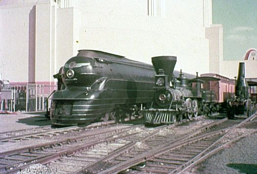

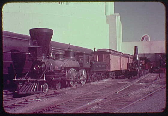

These look to be at an exhibition in the late 1930s, maybe "Railroads on Parade" as part of the New York World's Fair of 1939-1940:

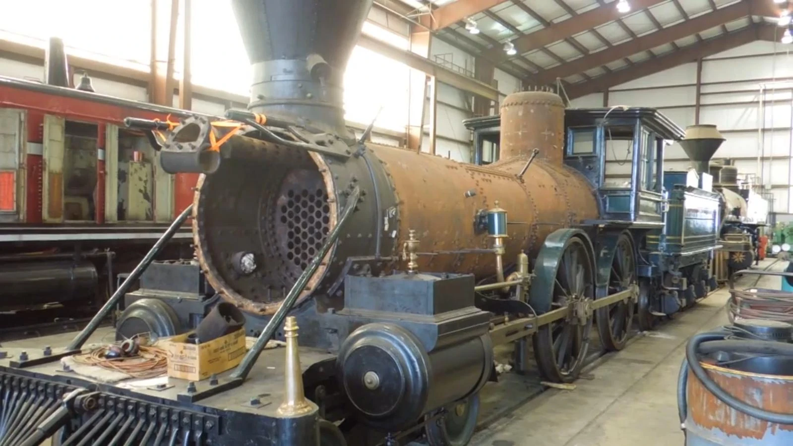

This is cool--under an earlier overhaul in 2013. The boiler looks like it has butt-seam longitudinal joints, but I have to say the welt plates look awfully narrow!

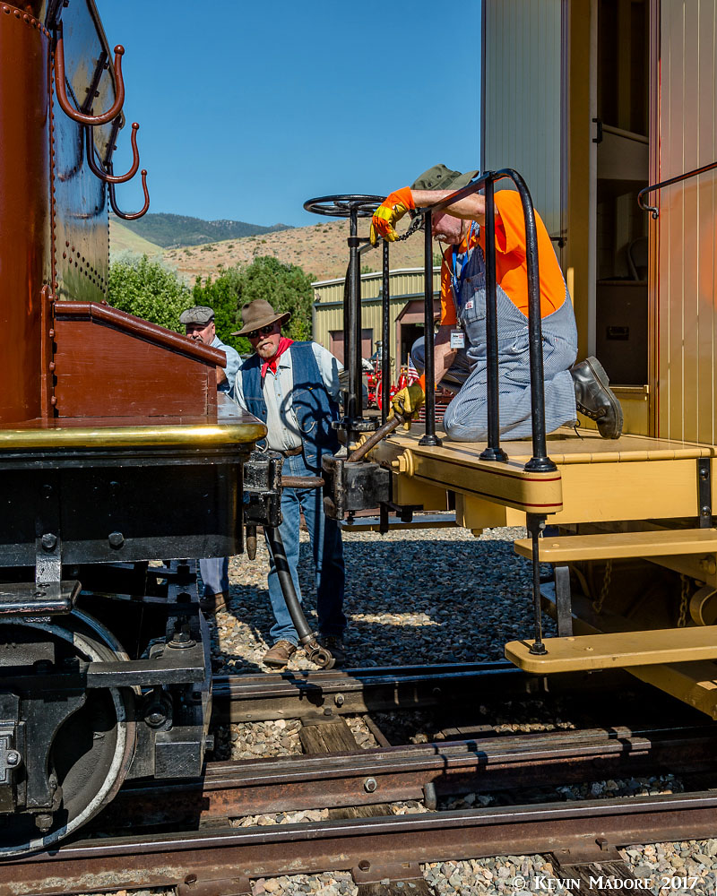

jayo wrote:
I've seen a video of the Inyo being coupled to a box car that way, it was at the NV State Railroad Museum, but not sure when. They probably would want to do it with the brakeman sitting on the passenger car platform inserting the pin, or hang the pin from a pole while standing to the side, like they do in the UK...
Correct. No personnel in the red zone. I've attached a photo of the V&T #22 being coupled to an 1873-era combine. Although the locomotive has an air pump, the combine does not have air brakes. When this train runs (for demonstration purposes, not carrying passengers), there is a Brakeman on the combine platform with a brake club.
