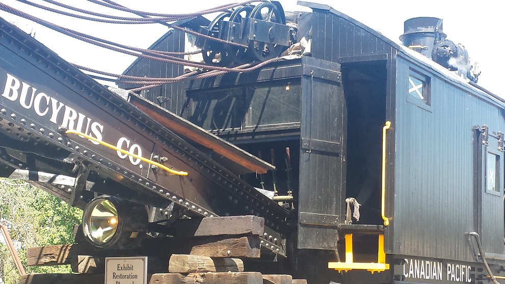

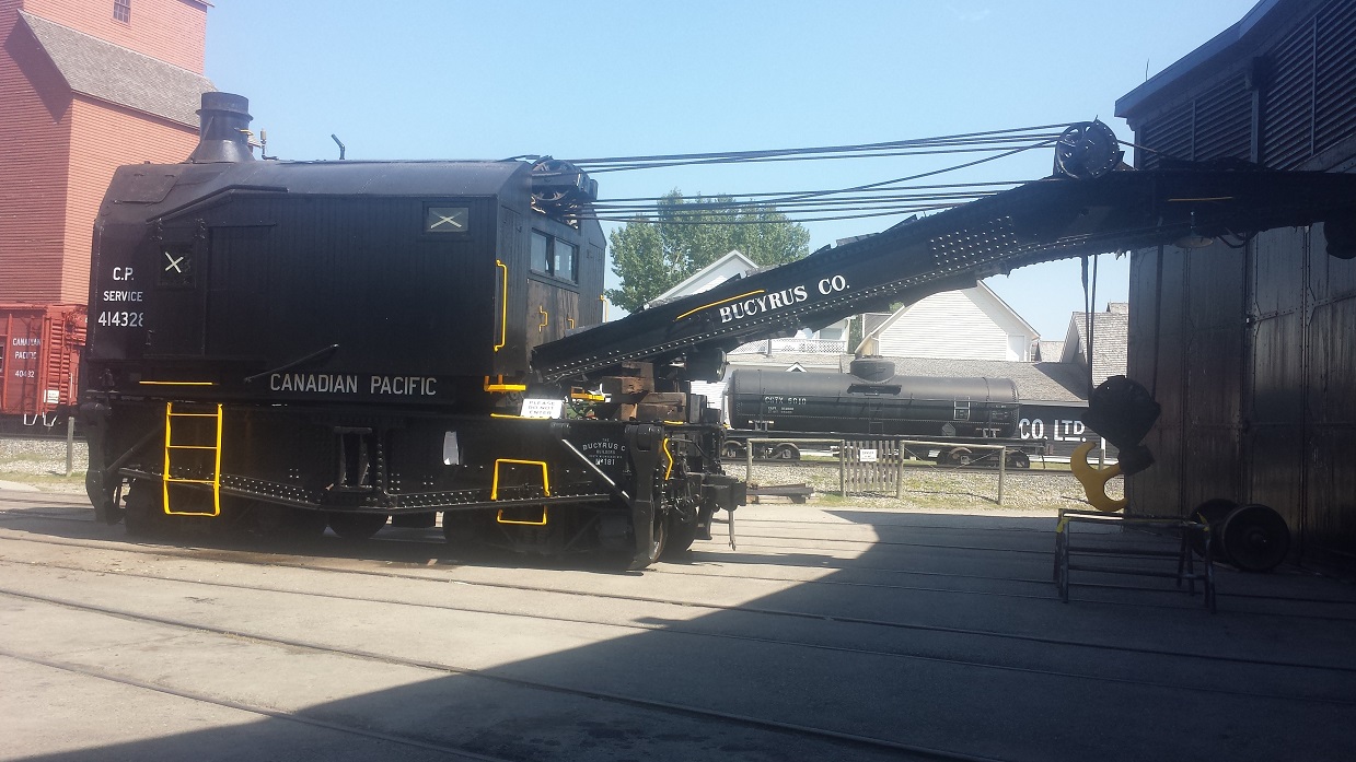

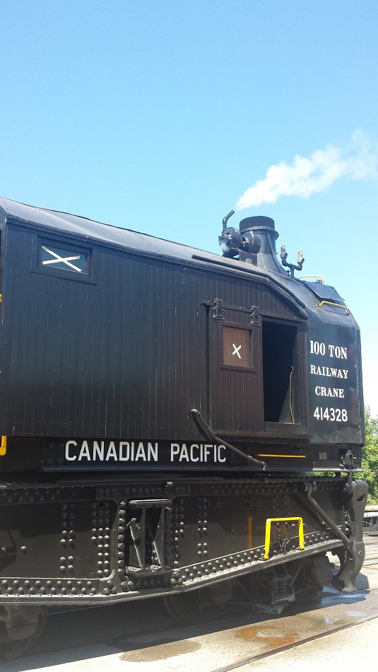

Last week was the day we got to finalize the work on getting the 100 ton Bucyrus operational on steam. I filled the new boiler and bunker with water, then warmed it up slowly to 125 psi. There were a few minor leaks, but both injectors worked first start flawlessly. Took it up to popping pressure of 160psi, then after confirming that the safety valves work, then we fired up the rebuilt dyno to check out the re-wired lighting system. All the ceramic fixtures were restored, along with the knife switch's and all worked as expected along with the headlight and rear spotlight. Next was the 2 steam engines, that I had worked on over the last couple of winters. Over a 3 day period we fired up the crane each morning and worked on getting the gremlins out of it. There is some adjustments needed on packing's and a couple of the control levers, but the boom main hook and lite hook all work as designed, the house swings and will be a great piece to add to the already impressive roster for the Heritage Park Railway.

Beautiful restoration! The tongue-and-groove housing is something I've not seen before on such a robust machine like a railroad wrecking crane.
Was the wood housing an original fabrication practice used by Bucyrus Erie?

Thanks John. Yes the wood siding on it is a mirror of what we removed. The house was almost all rot after sitting outside on a siding for over 40 years, so it was removed and anything we could preserve we did and the rest was fabricated. The old siding was used as a pattern and new clear fir siding was milled for replacement. Maybe because the crane was used between Field, BC, through to Lethbridge and in the Crowsnest Pass area it needed more protection for the operators and engines from the elements. The 2 front doors are the only original pieces visible from the crane, everything else was fabricated from the original.

Well, after 9 years of working on the crane, this weekend was the day to fire up for the public at Heritage Parks annual Railway Days. This year's theme was "Full Steam Ahead" and was a celebration of not only Canada's 150th birthday, but a way to bring to life all our artifacts to educate the public on the very importance of the railway in the formation of our country. This year we brought out everything we have that runs on rails or steam including a 1916-65hp Case tractor, a 1912 Waterous steam roller (only one operational in Canada) a 25hp Oilwell Supply stationary engine, double heading with the 2 steam locomotives , the only place to see this in Canada, and the 100 ton Bucyrus crane - the only operational steam railway crane in Canada. It worked flawlessly for the 2 day event, and before we put it to sleep for the winter, we are going to put it to work for a few move lifts.
