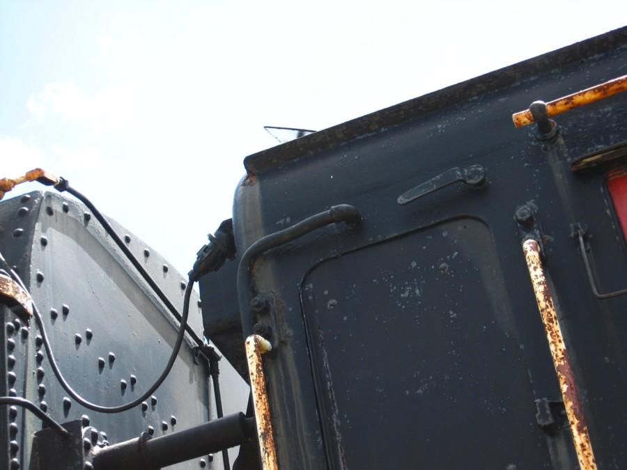

One classic story is of a CNR 4-8-2 that had one of the larger steam pipes in the cab burst. Both the engineer and fireman bailed out of the cab via the cab windows, and of course both the Feed Water Pump and Stoker were going full tilt when the incident happened. I believe the engineer was ultimately able to make his way to the front of the locomotive and open the angle cock to stop the train. The account I read was told by the fireman, who noted that when he bailed, he had no idea if the engineer made it out or not until the train came to halt when the engineer opened the angle cock on the pilot.
This may have been what motivated CN to retrofit an emergency brake valve just outside the engineer's door on most if not all of the fleet.
