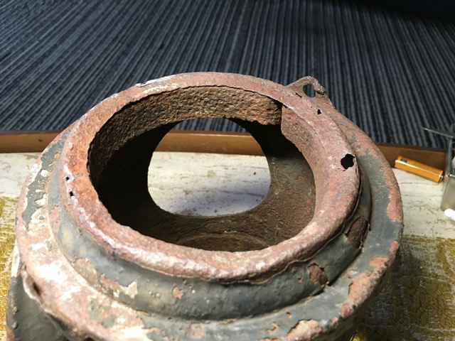

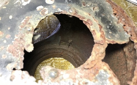

I think I may have discovered another clue about the internals. The opening of the top of the body has a spot welded inner collar added to the shaped upper shoulder of the body. This is below the cap roof. It is of two pieces of which the butt ends are brought together in a ramped valley. There are two of these notches 180 deg. apart. They are located 45 deg. off the axis of the two lens faces.
I believe these to be the detents for indexing the cylinder for the colored lenses.
I'm pretty sure this marker light was only white or green or off for selections.
No idea if this was accomplished with a flat or curved lens. There is quite a bit of room to "orbit" the light bulb.
The first pic is looking at the inside of the top from the center hole of the bottom. This bottom hole is girded by three screws. I think the attached plate mounted the socket, and possibly a guide ring for the base of the rotating inner cylinder. The fork at the end of the case knob could slip into the electrical switch shaft of the socket. I believe the bulb would be changed by dropping everything thru this hole.
You can also see the remains of something on the inside wall of the body above the indexing notch. No ideas on that detail yet.

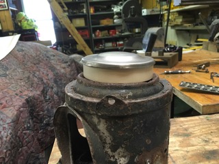

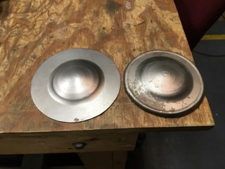

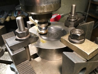

Thought people would be interested in seeing how the first replicated marker component is shaping up. Working on developing the lantern tops. Looks pretty close to what appears in the various photos we have found. The doming was done on a Bridgeport and rotary table using a technique called single point incremental metal forming. The metal is stretched similar to spinning but no form is used.
Bob D

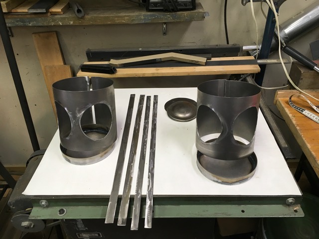

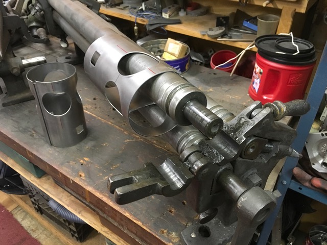

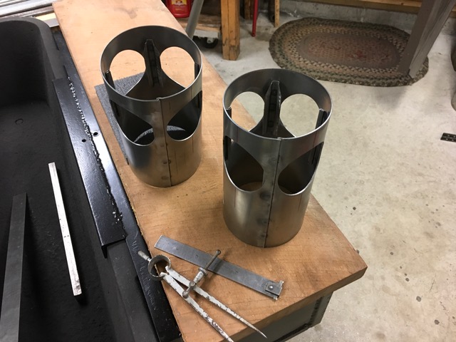

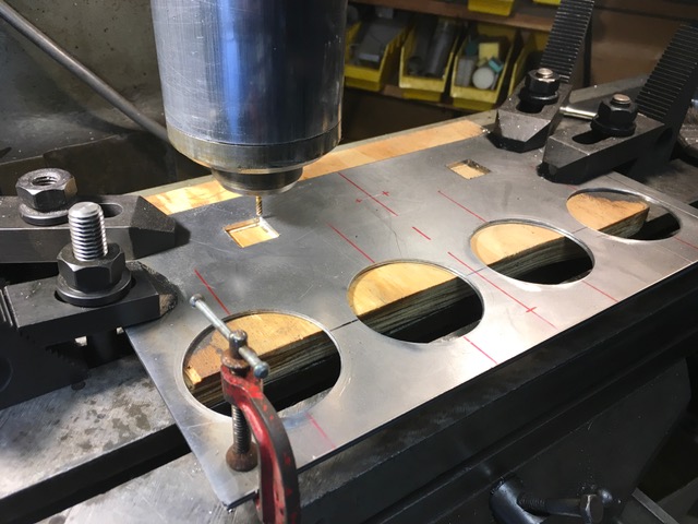

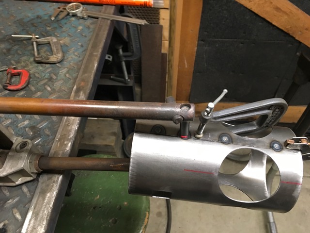

Thought some of you would like to see some of the progress on the replication of these marker lights. Has been an interesting project that I bet has not been done very many times.
Bob D.
