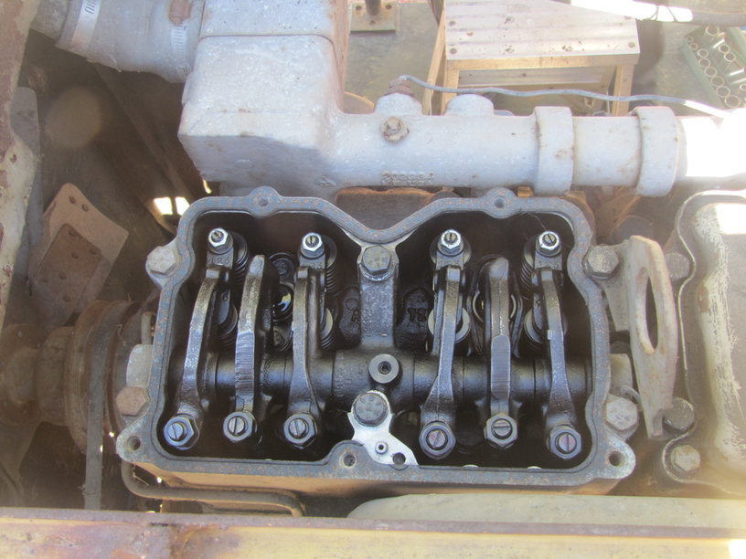

Today was the crucial day to work on the engine. I was afraid that every bolt and nut would be rusted and the engine would be a disaster.
Fortunately, that was not the case! All the bolts on the valve covers came off rather easily, and the valve train looked like it was brand new. No rust, no gunk, no foreign bodies.
We removed the #1 and #2 metering rods and springs and put each in a numbered ziplock bag.
We then drove into town and met with the Cummins people. They were very helpful and a mechanic showed us the special tool they use to remove the injectors. We then went to Harbor Freight and bought a similar tool.
After that we came home and soaked our tired bodies in the spa.

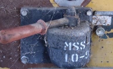

In the process of identifying everything changed on this switcher, I am not sure what this part is. The original 14E1 valve was replaced by an SA-2.
 Post subject: Re: GE 1941 23 Ton Switcher
PostPosted: Sun Nov 19, 2017 12:39 pm
Posts: 783
I am sure SA would be 'straight air' and that the trainline brakes have been eliminated
