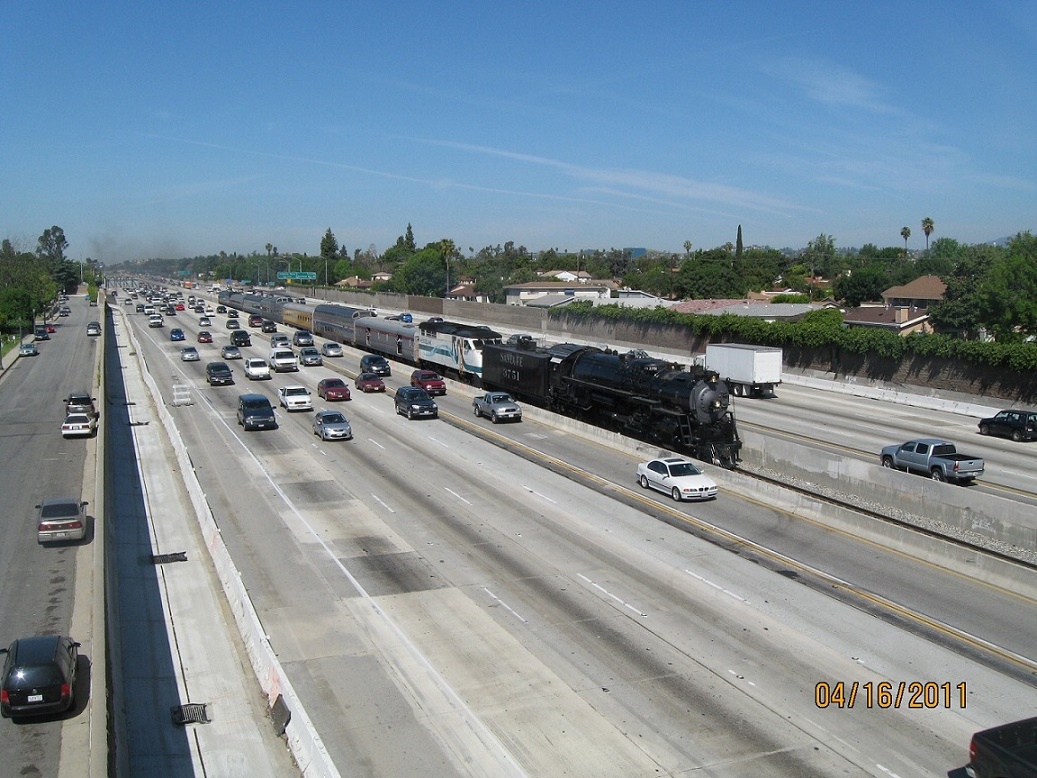

Here in the Los Angeles area, we have had several trips between LA and San Bernardino on the Metrolink line with ATSF 3751. The only condition for most of these runs has been that a Metrolink diesel be added to the consist. But these runs are probably not "tourist trains" in the sense of running every weekend.
Here's 3751 as seen on 16 April 2011, in the middle of the San Bernardino Freeway, heading for San Berdoo on a Saturday morning. What makes this especially noteworthy is that the route it's following is a former Pacific Electric line that only carried steam locomotives during World War II.
