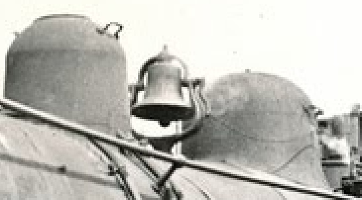

Well, I'm not saying that yours is definitely not a Baldwin bell; maybe it's a more modern vintage, but you really think the two bells look identical?
Look at the top of the bell. Yours seems to taper more towards the yoke; mine appears flatter, for instance.
Look at the area where the bell meets the yoke. On mine, it's seamless; on yours, there is not only a gap, but the shoulder of the yoke where it's supposed to meet the bell does not match with the shape at the top of the bell.
Those are just a few things that I think are pretty apparent.
Let us know what you find when you remove the top nut.

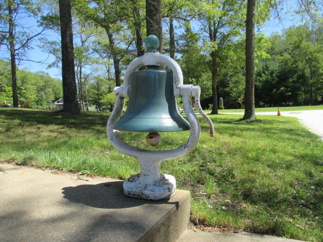

Here is my Rhode Island bell in its previous life as a lawn ornament, before I purchased it. (Yes, someone thought it was a good idea to dress this beautiful bell up with white housepaint -- just awful. I'm going to have to do something about that...) It's 17" in diameter and 35" tall overall from base to top nut. If you look closely you will notice that the base of the pedestal is angled from front to back, and so a steel wedge or shim (the former owner called it a "leveling block") is required for the bell to remain vertical, which suggests to me it was intended for use on a wagontop boiler. The downward-turned pull arm appears to have been common practice on the New Haven, but I don't know the reason for it.

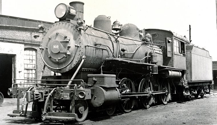

And here is what I believe to have been one of the engines that carried the bell, New Haven No. 960 (ex-158). Note the location of the bell right at the flare of the wagontop boiler:

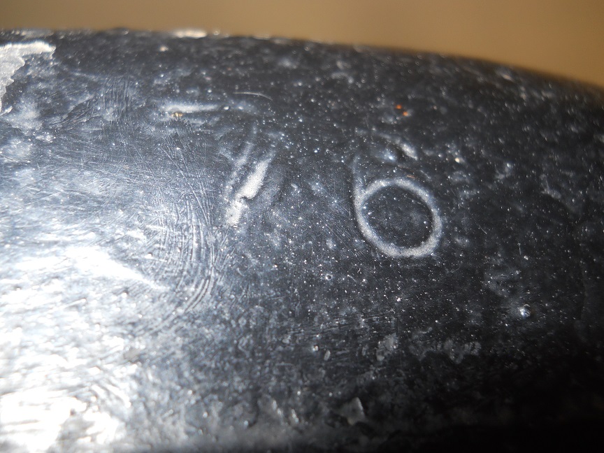

The number and "S" cast into the yoke and shown in the original photo might be a clue to the builder. Are there other bells of known parentage that have similar markings?

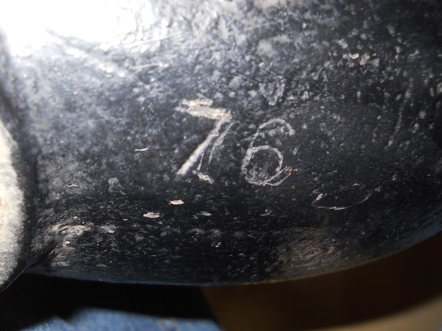

Arrived very late to the museum yesterday, so didn't get much chance to check out the bell. I did find out the nut size (1-1/2") but when checking for that, was surprised to see the number 76 stamped into the yoke on both sides of the shaft/nuts. These numbers of course, correspond to the number stamped into the top of the bell itself. Photos of these yoke numbers included below.
Still have to check to see if there is a number on the bell shaft as mentioned earlier in this thread. Will need another set of hands to help with this.

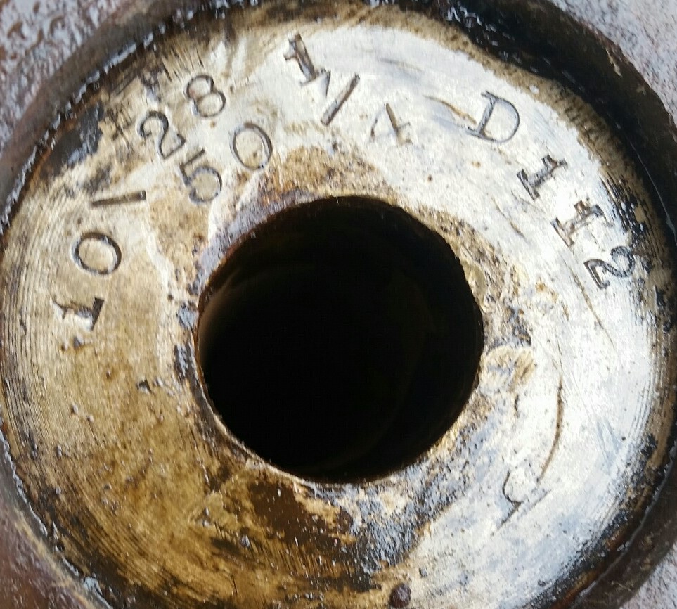

If you can see it, the Baldwin Classification code stamped into the end of the bell, around the ringer bolt hole will look something like this. Other builders did not use this type of code on bells. It will tell you the exact engine the bell was on when it was brand new. Baldwin stamped this code on lots of things, including the back of builders plates. I can figure it out for you if you can find the class number, and post a photo of it.

Here's how to decipher the Baldwin classification code, given BLW class 10 28/50 1/4 D 112 as an example:
-10 is the total number of wheels on the engine;
-28/50 indicates size of the cylinder and as a fraction it also indicates it was a compound engine (to determine high and low pressure cylinder sizes, divide 28 by 2 = 14 and add 3 = 17" cylinder; 50 is 28" cylinder)
1/4 means the engine had front and rear trucks at ends (e.g., 4-6-2)
D indicates three pairs of driving wheels
112 indicates it was the 112th locomotive built by BLW to this class

In the example & photo, 10 28/50 1/4 D 112 comes out to be Santa Fe 2-6-2 #1111. That class of locomotive began as AT&SF 1000, and it would have been stamped 001. The 111th engine would have been 112.
