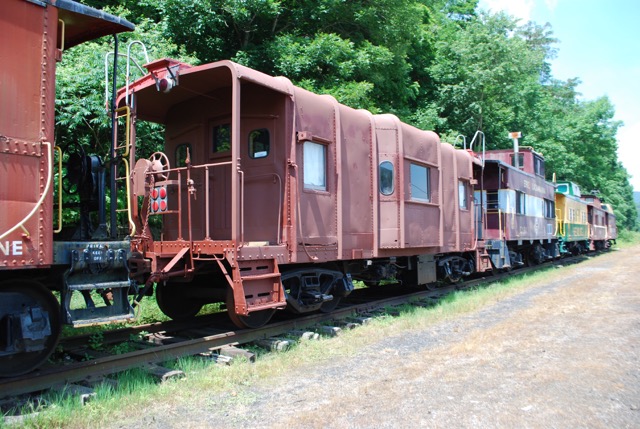

Wagon top construction was also used in B&O covered hoppers and cabooses (I-12's and I-5 rebuilds).
I came across this photo from June 2010 of a wagon top caboose at Jim Thorpe, PA. I do not know anything about it or if it is still there.

That cabin belongs to Ed Feathers. It was moved from Jim Thorpe to Kutztown on the A&ARR. It's been beautifully restored and I have received more than a few offers to pair the boxcar and this together. Ed is a very nice guy who has helped me more than a few times. Hell he was my engineer last night!
Thanks for sharing.
