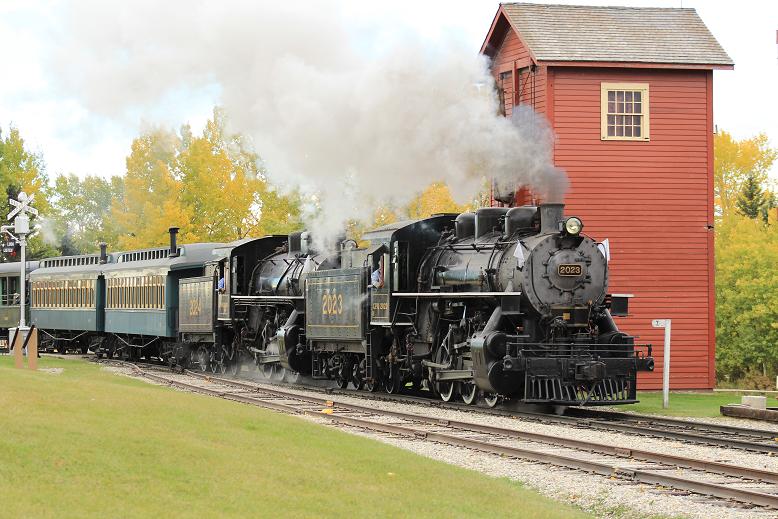

Here's the 2 we have, now carrying CP rail numbers from the unused bank of engine numbers from 1914. The 2023 is USRA # 4012, and the 2024 is USRA #4076. We have our Railway Days every year on the last weekend in September, and this is the ONLY place in Canada you will see doublehead steam locomotives.
