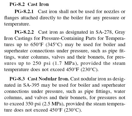

ASME Section IV Heating Boilers allows boilers to be made of cast iron for a maximum pressure of 15 psi.
ASME Section I Power Boilers allows:
1. Gray cast iron components of SA-278 for pressures up to 250 psi.
2. Nodular cast iron components of SA-395 for pressures up to 350 psi.
