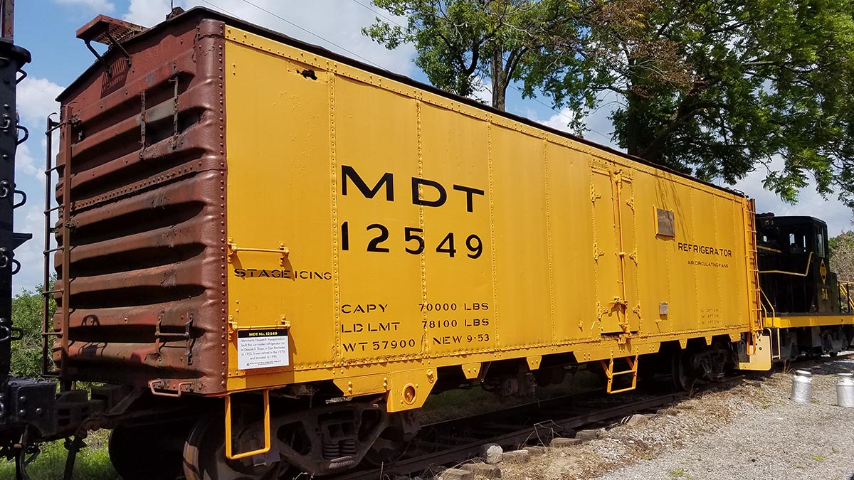

Just an update, MDT 12549 received lettering and paint touch up on the east side this past August in preparation for a night photo session we were hosting.
File comment: MDT 12549 at RGVRRM in 2017
The only thing missing is the horizontal bars framing the reporting marks and the large NYC logo above "REFRIGERATOR." The graphics were supplied by Accurail, which I then scaled up to 1:1 size, edited to suit our car, and then had cut in house with our museum's vinyl cutter.

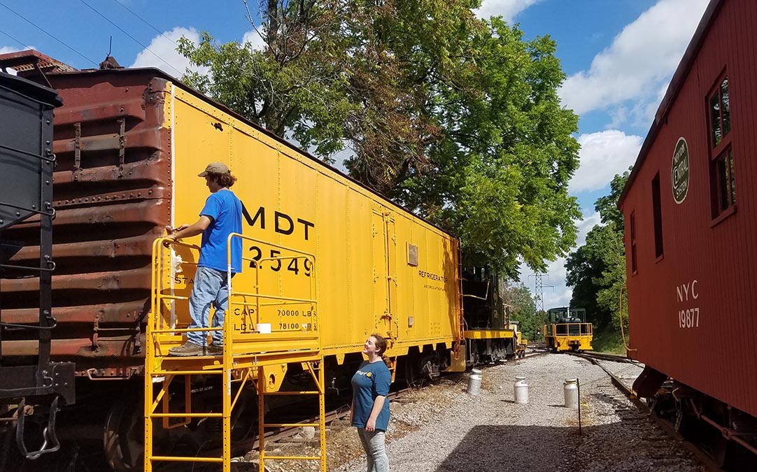

Getting some help with the paint touch-up on the car ends. For now, Rustoleum's Rusty Metal Primer is a close enough match for the original color of the car ends. Volunteer Adam Lloyd has masked off the rivet line and is applying a coat of paint.

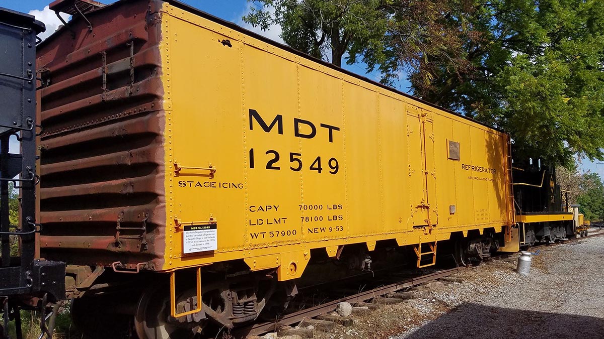

How the car currently appears on display at RGVRRM in August 2017. Horizontal bars framing the reporting marks and a large NYC logo are yet to be added in this view.
