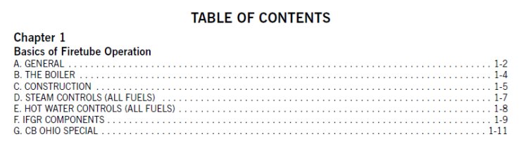

If this is the only justification for the blanket 5.0 factor of safety, since when did the ASME NEW construction CODE care about future repairs or local jurisdictional compliance? Today, if you want to buy a Cleaver-Brooks package boiler for use in Ohio, you have to tell that to C-B before ordering the boiler. Taking responsibility away from the design engineer by adding a 25% penalty can and will lead to serious boiler condemnations and deratings in the distant future without subsequent increase in inherent safety.
