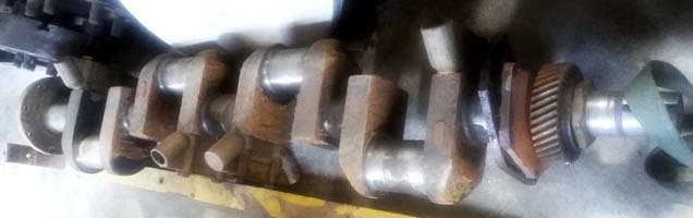

As far as crankshafts to send to California for measurements, look what I ran across this at a museum in California.
Notice it's a flat crank - no twists. Bolt-on counterweights. Lends itself to being cut out of billet.
