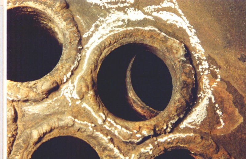

If your boiler-maker/inspector/guru does not know exactly where and why the tube is leaking, it should be removed from service.
If it was rolled more than twice, under working pressure hydro just enough to make it tight, it is over rolled and failure is imminent.
If the boiler was not baked dry during the off season, corrosion continued to decrease the tube wall thickness during the layup period.
