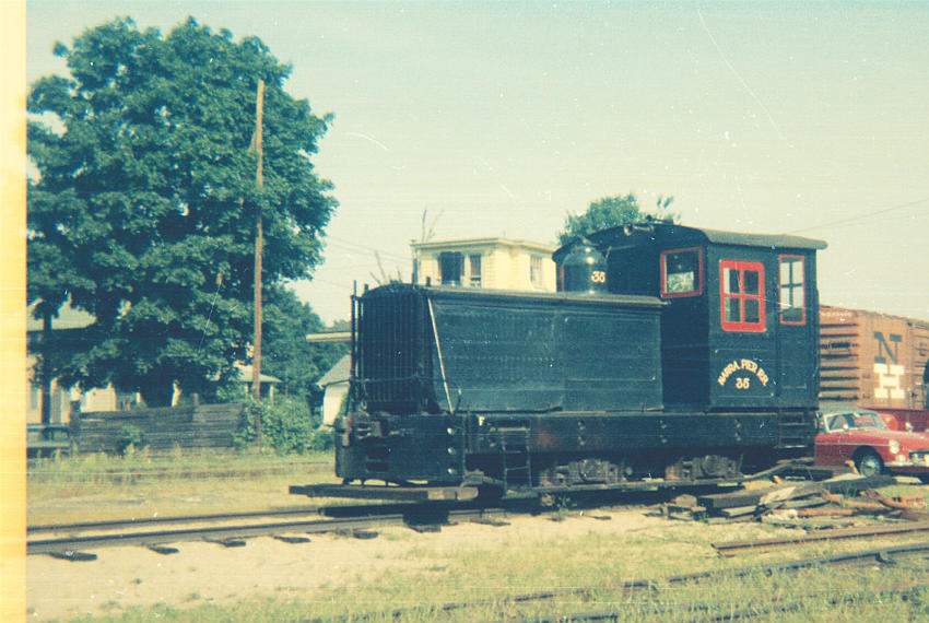

When I worked on the Narragansett Pier Railroad in the mid to late 1960s, Tony Hannold, then owner of "the Pier," acquired a 25-ton Plymouth that had a six cylinder Le Roi gasoline engine. It was a hoot to operate with the clutch & long gear shift lever. I swear the four-speed gear box and transfer gear case were bigger than the engine. Top speed in fourth gear and full throttle was around 7-8 miles per hour.
I believe No. 35 ended up somewhere in New Hampshire, either at Clark's Trading Post or the Hobo Railroad. I have no idea whether the loco is still there or in what condition it's in.
Thanks!
File comment: NPRR No. 35 taken in front of Peace Dale, RI depot, cs. 1969.

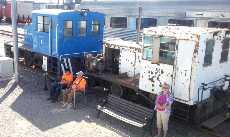

There’s a LeRoi engine with a blown out block in a stored Plymouth at the Southern Michiga— wait a minute.
daylight4449 wrote:
If the Cummins that's in it now is putting out RPMs higher than the transmission can handle, wouldn't it be easier to do some sort of reduction gearing before the transmission?
At the time, a search was made for a bargain basement gear reduction, and a new one was priced. That was the end of that. There was no money; SMRS had only started and was improvising operations with speeders. The decision was to train operators to limit engine RPM, however that proved difficult without a tachometer or reprogrammed governor.
Of course, there’s a very practical way to get well regulated 0-1000 RPM at 20-40 horsepower continuous (200hp peak) at a sensible cost. It’s staring you right in the face. Wasn’t so common in the 1980s but today, sure.
John Deck wrote:
There are three known Plymouth engines with LeRoi V-8 gas engines that I know of left. ... The second is located in Chandler, AZ at the Arizonia Railroad Museum. It had a major air compressor failure and is in the process of being rebuilt using parts from two donor engines they found in Texas that had powered a cotton gin.
I was just there, at their annual open house. (this is their busy season; they are closed in the summer.) Very impressive operation, or to be more precise, non-operation, though they have a number of operational units and a healthy member base. Even a PRR faction, as well as several NYC coaches. Virtually everything is tip-top. The passenger coaches are by-and-large HEP and powered from shore power with air conditioning operatonal, and very attractive displays inside.
John Deck wrote:
Most torque converters that are married to a Cummins are Twin Disc and they are very rebuildable. The rpm's do have to be adjusted to match and also you need to look at the how the fluid is routed to the aftercooler on the front. Another big killer is there is an air leak and the system gets full of air. That will kill a converter also.
Plymouth #1 arrived at the museum with a Twin Disc torque converter behind a Leroi. This was clearly a kitbash, as the unit had shipped originally with a clutch. (It is common for conversions like this to fail, and for those disasters to end up at railway museums where volunteer staff bang their heads bloody against the wall trying to make it work (when it never did before)… but that is not the case in this situation.) The Leroi + Twin Disc did its job for years at Hayes-Albion. The locomotive was retired when the Leroi engine had a problem.
Indeed the torque converter is Twin Disc, though the Cummins came after SMRS acquired the unit. The issue was that the Twin Disc was rated to an engine that turned 1000 rpm max, and the Cummins turned closer to 2000. The Twin Disc was indeed a very reliable unit, no doubt helped by the failure mode: around the perimeter of the torque converter are “dump valves”, simple diaphragm valves held shut by hydraulic pressure piped radially on tubes. These drained the torque converter when you disengaged it. The diaphragm pushed inward against the centrifugal force of the fluid, so over-revving would, at best, overpower the diaphragm and drain the torque converter; and at worst, break the dump valve. We had a lot of both, and resorted to building new dump valves, but never quite solved the problem. Obviously the answer is slow the torque converter down to a speed inside its range.

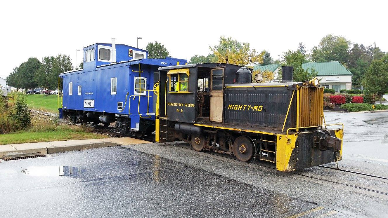

At Stewartstown, our Plymouth with original LeRoi engine is running well, and will start pulling trains again in April! Come on out and take a ride - cab rides are available...
