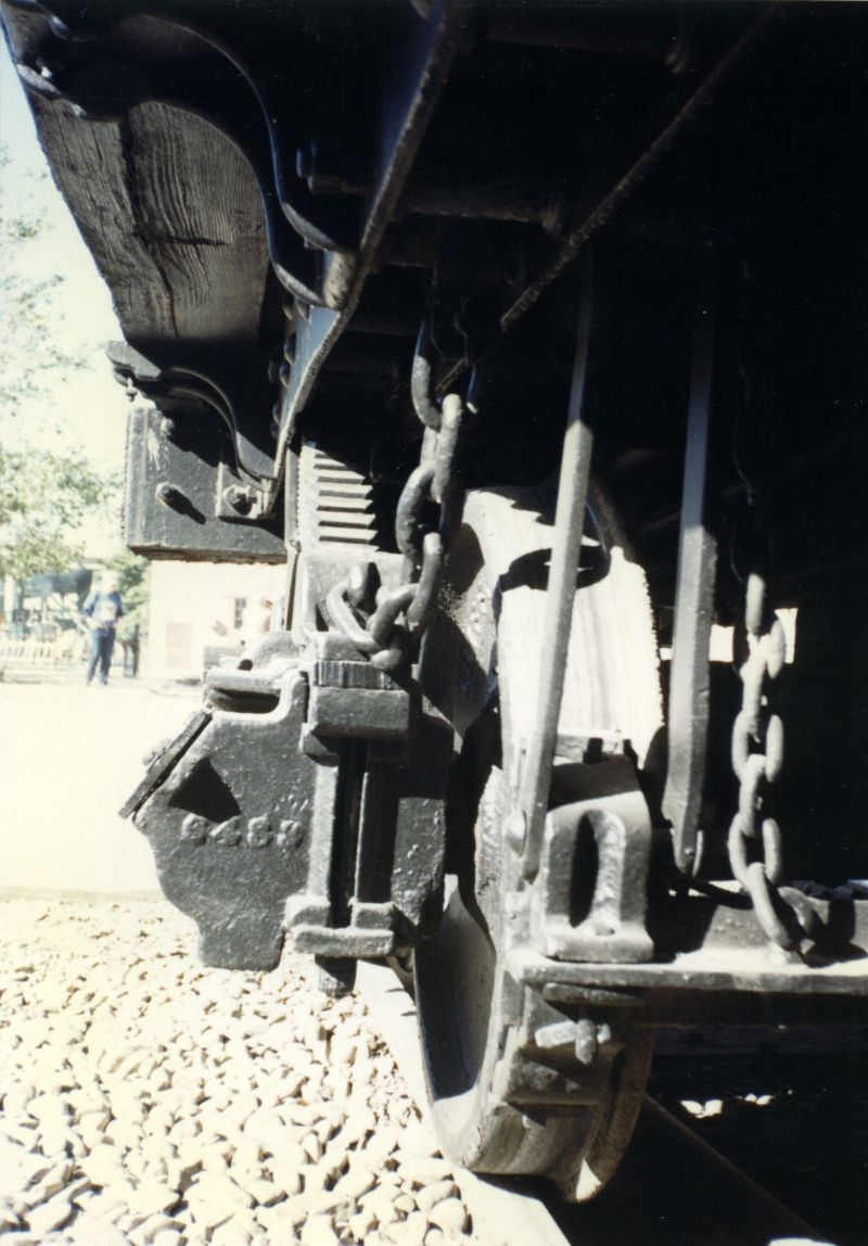

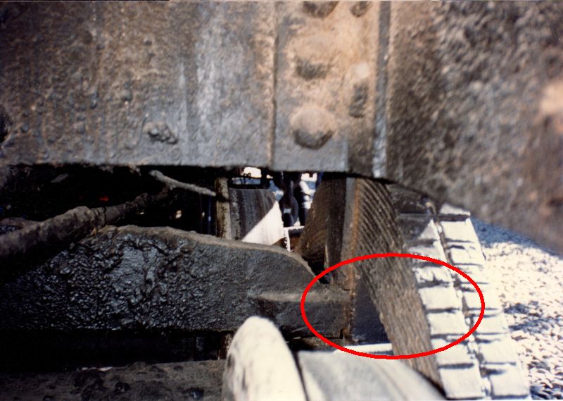

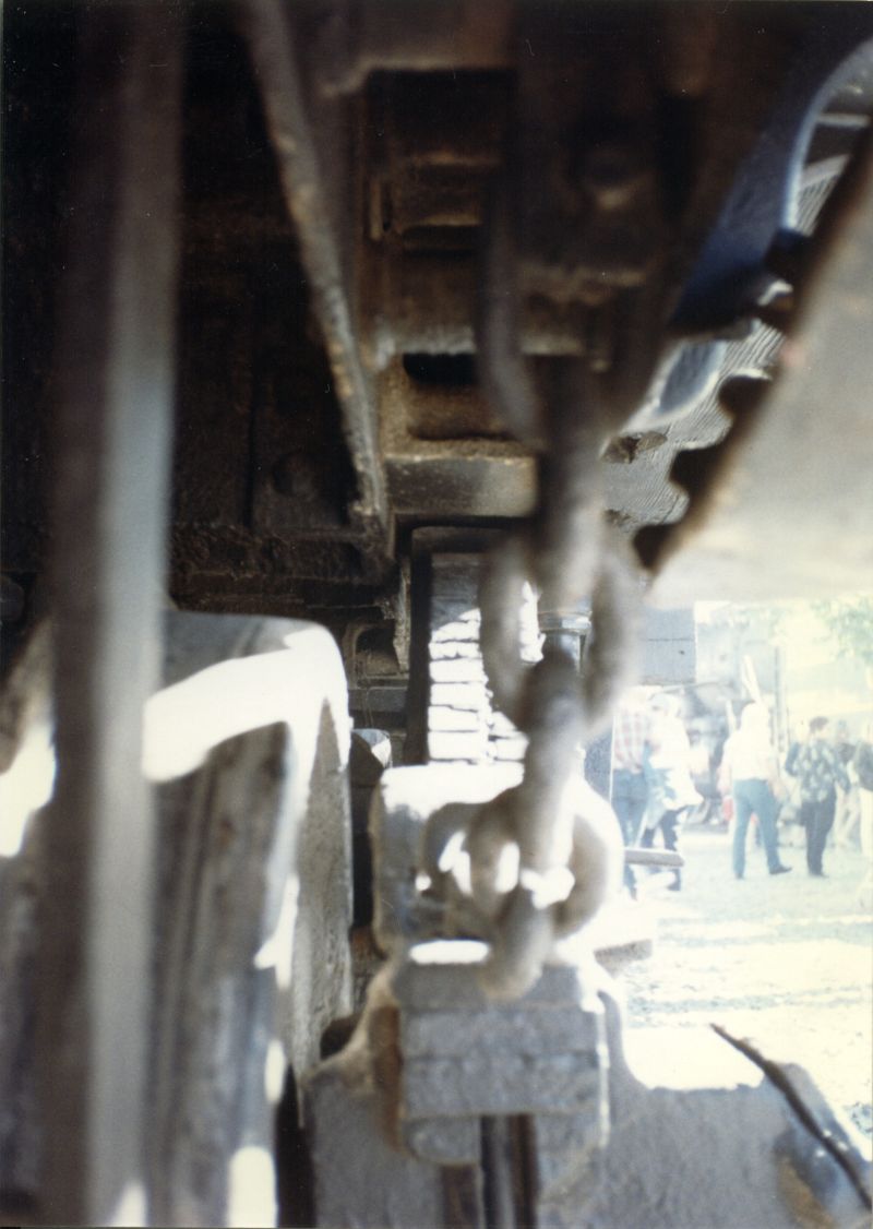

I already posted the first photo. The circle shows where the cross equalizer hangs from the bottom of the spring and supports the weight of the front of the tender. (Cross equalizer may not be what CP called it. I call it that because is similar to the cross equalizer at the front of the suspension of our Consolidation.)
The two additional photos give a bit different view. I haven't' tried to tell whether they are of the front or rear truck.
Note that the first couple of photos of IID #551 in the thread show the frame at the front truck is bent next to the spring clamp. That suggests to me that the spring is not firmly secured. A different view of the spring hanger is shown in those photos.

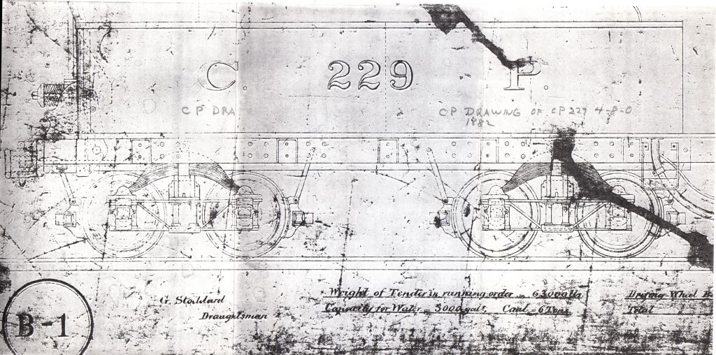

I found a drawing of the tender for CP-229 (circa 1882?) that the late Charlie Dockstader sent me a number of years ago. Charlie was a master modeler of live steam models and built operating 1/8 scale models of CP-229 and El Gobernador. He also designed and placed in the public domain a simulation program that covers at least 20 types of locomotive, tractor, and steam boat valve gear, including one of Stevens' designs.

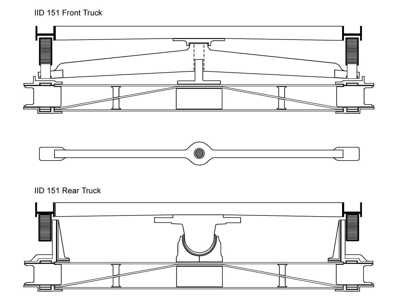

Mr. Travis -
This appears to me to be the way it goes together, with some guesses in the rear truck where we can't see how the castings connect the side frame to the truck bolster or the spring guide/spring interface. It isn't to scale since I have no measurements, and I exaggerated a couple of things for clarity. The two trucks are different, but all loads to the truck frames pass directly from the spring ends to the pad atop the journal boxes (not shown). Note the difference in side sill bolt/rivet patterns between front and rear, suggesting different types of frame spreaders.
The front truck provides the 1st of the three load points via the center plate and beam to the hanger links incorporated into the spring bundle. The top of the beam doesn't telescope, it is the center plate bearing for the truck. Only the pin that rises from the truck bolster telescopes into the beam and acts as a guide to stabilize uncompensated motion between the truck frame/springs and beam, with most of the motion taking place at the center plate/beam contact like a more traditional truck mount. The spring bands on the front truck appear not to contact the side frame plate in the more recent post and probably act as non-constant-contact side bearings to improve overall stability somewhat.
The rear truck provides the 2nd and 3rd (side) load points at the frame/spring-clamp contact point. I see what looks to be a rubber liner in the rear truck center bowl that I would assume is for additional flexibility and assume the ball does not normally contact the bottom of the bowl on the truck bolster as shown. I think there is probably some type of slide on the back of the spring bands on this truck that is guided by the vertical channel you see attached to the top frame casting to help keep the springs in proper location.

It appears to me that the pic labeled 'side' is the front truck (engine step visible and sun/shadows reversed from 'side 2') and 'side 2' is the rear truck (frame bolt pattern, no engine in background, and corner of rear kick-board visible). The fact that neither is in complete shadow would put both views on the right side of the engine.
Since the spring groups on the front truck have no guide or stabilization, their position relies entirely on having weight constantly on the hangers and spring ends, so if the tender rocked violently or was otherwise lifted and set down (or dropped) without attention to keeping the springs vertical, they could rock either direction and have the side frame land on them. With their advanced age, I would guess that there's quite a bit of wear that would prevent the springs from staying vertical with or without a load.
Another observation is that 151's front truck bolster appears bent (and probably broken) in the 'kingpin and cross equalizer' pic, with the left side frame accordingly tilted in the 'front journal' pic. Also, note the welded up holes on the side sill above the rear truck and new rivet pattern. Frame repair for worn out spring pad?
The CP229 drawing is interesting in that it shows two identical trucks similar to IID151's rear truck. Maybe they tried doing away with three-point on this one?

Train Detainer - I think I agree with your description.
My understanding/recollection is that the weight on the front truck passes from the car bolster to the cross equalizer. The ends of the equalizer hang from the center of the springs by the bands around the springs, where the weight is transferred to the springs. The ends of the springs transfer the weight to the casting above the journals and the ends of the springs are able to move fore and aft on top of the journal as the springs are compressed or relaxed.
On the rear truck, the weight is taken from side bearings on the underside of the frame which rest and slide on plates on the top of the springs so the truck can pivot. The ends of the rear springs are able to move fore and aft on top of the journal as the springs are compressed or relaxed.
The ball joint (or maybe more of a cup) on the rear truck locates it side to side and front to rear but does not transfer any weight.
Although it appears to be bent, I don't believe the front truck bolster carries any of the weight at the center. In 135-140 years almost anything could have caused a bend. Since the side frames and truck bolsters are rigidly attached to each other an incident causing a twist of the side frame could have sprung the bolster.

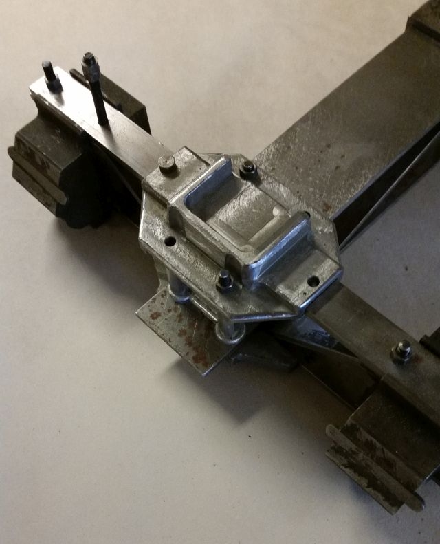

I got a few dimensions from the IID #151 trucks. The side frame top bar is 1" thick, the arch and bottom bars are 7/8". All are 4" wide. The space between the bars for the journals is 8-1/4". The two columns/bolts at the side of the large center column casting are spaced at 6-1/2". The three columns at the side are spaced at 5". The main bodies of the journal castings are 7-1/2" wide and hole spacing for the covers is 8-1/2". I measured wheel base at 44-1/4". The tank is 17' long.
Attached is a partially completed model which shows my take on what the casting on the top of the front truck looks like. (The piece of the lower part of the truck bolster sticking out still needs to be trimmed.)
