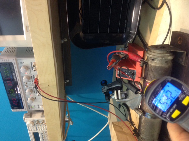

Here is the resistor on the bench. Turns out I botched my previous measurements, resistance is actualy half my numbers above, which means I need one of these, not two. But can it handle all the current?
Here I put 6.00A at 25.90 volts into the high current section. This 155.4 watts of power stabilizes at 550 degrees F, and running for a half hour, the resistor is not glowing or showing any sign of distress.
Unfortunately this bulb calls for driving 7.5A through it, which would be 243 watts. I can't test that, I am at currentmax for this power supply.
And of course its value of 4.3 ohms falls shy of the ~5.0 ohms that field testing shows is needed.
File comment: Getting warm
