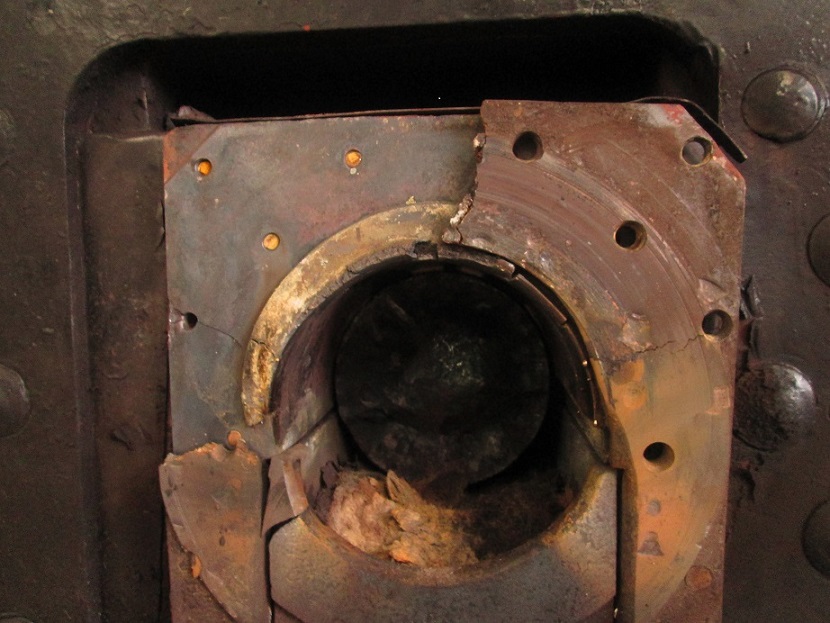

The loco in the video is Ab663 built in Addington (Christchurch) New Zealand in about 1917.
It has plain bearings on the drivers.
The incident happened last weekend in the Plimmerton yard of Main Line Steam just minutes after the loco had returned from a 200 mile main line excursion. Had the excursion train been heading the further 15 miles south to the capital city of Wellington, the incident would have happened while running at 40 mph along side the bay.
Fortunately, in this case, due to the ever restrictive rules on steam locomotives passing through tunnels in New Zealand, the excursion terminated at the village of Plimmerton which is now Main Line Steam's main base after loosing their Auckland facility to housing development earlier this year.
The incident was caused by lack of lubrication of the bearing journals.
Trevor Heath
Casa Grande, Arizona
